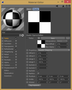

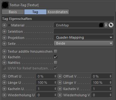

The exporter transforms your current material projection to UVMs.thesquirell wrote:I was wondering if there is way to set up/access rotation/scale parameters of a texture from C4D?
So simply use whatever tools in C4D to modify the projection as you like!
Rotation and viewport based transformations are done by having these tools active:
