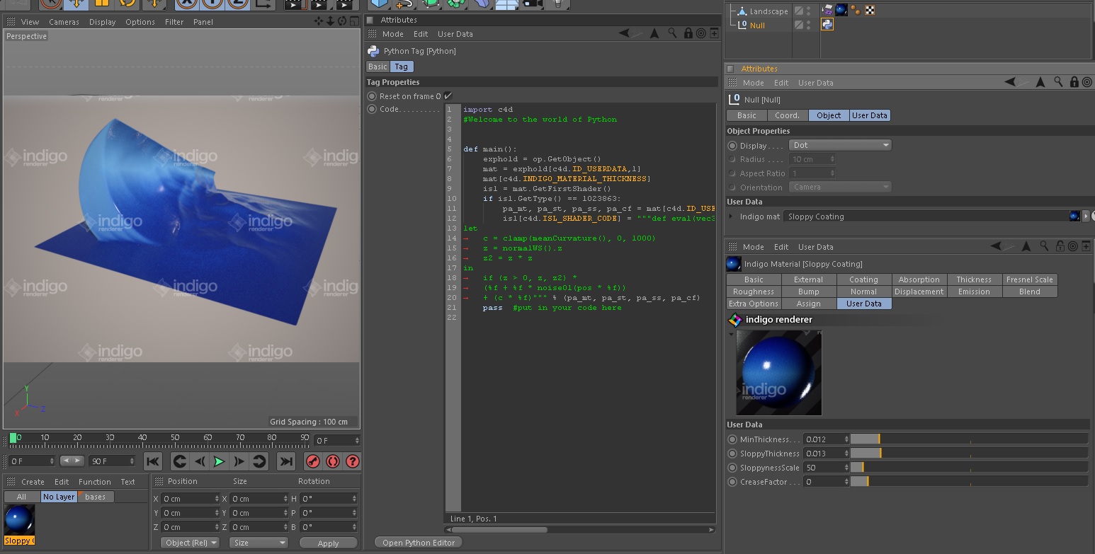

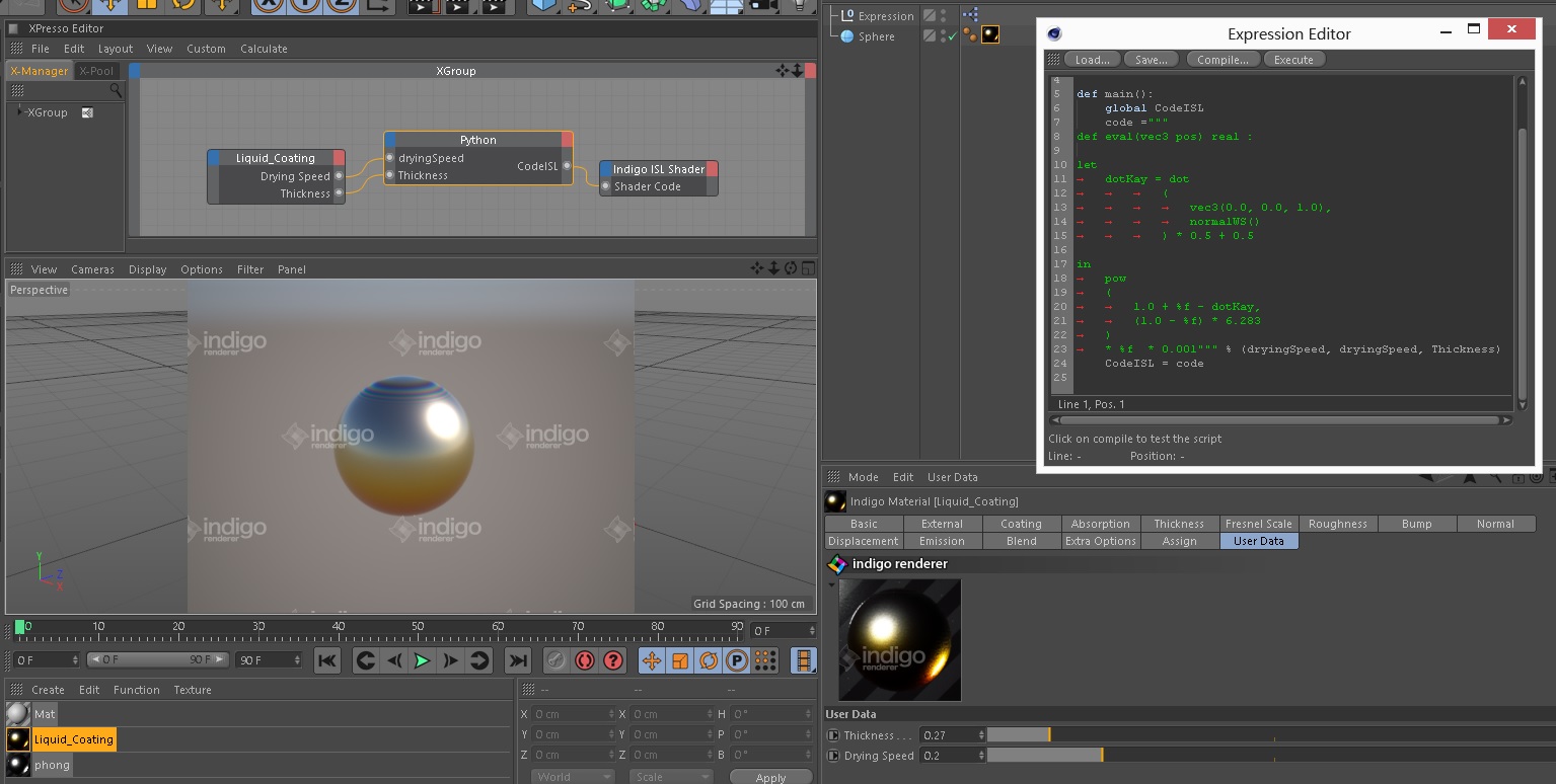

There is small help to control parameters in cindigo isl.
go to user data of mat and you can to control additional options as Thickness and Drying Speed
Prototype based at CTZn's material - Liquid Coating
Isl_Python.zip
c4d scene - c4d r16.021
(85.98 KiB) Downloaded 377 times
I'm sorry for my bad English

If somebody needs to understand how to work, look at:

Another way - python tag
based at http://www.indigorenderer.com/node/1945
fused, thank you, nice for waves
p.s. mat[c4d.INDIGO_MATERIAL_THICKNESS] - this part you don't need

Post by Ilay » Fri Sep 19, 2014 3:51 am
I do not do it :oops:
fused and CTZn made, i only add control gui by simplest way
