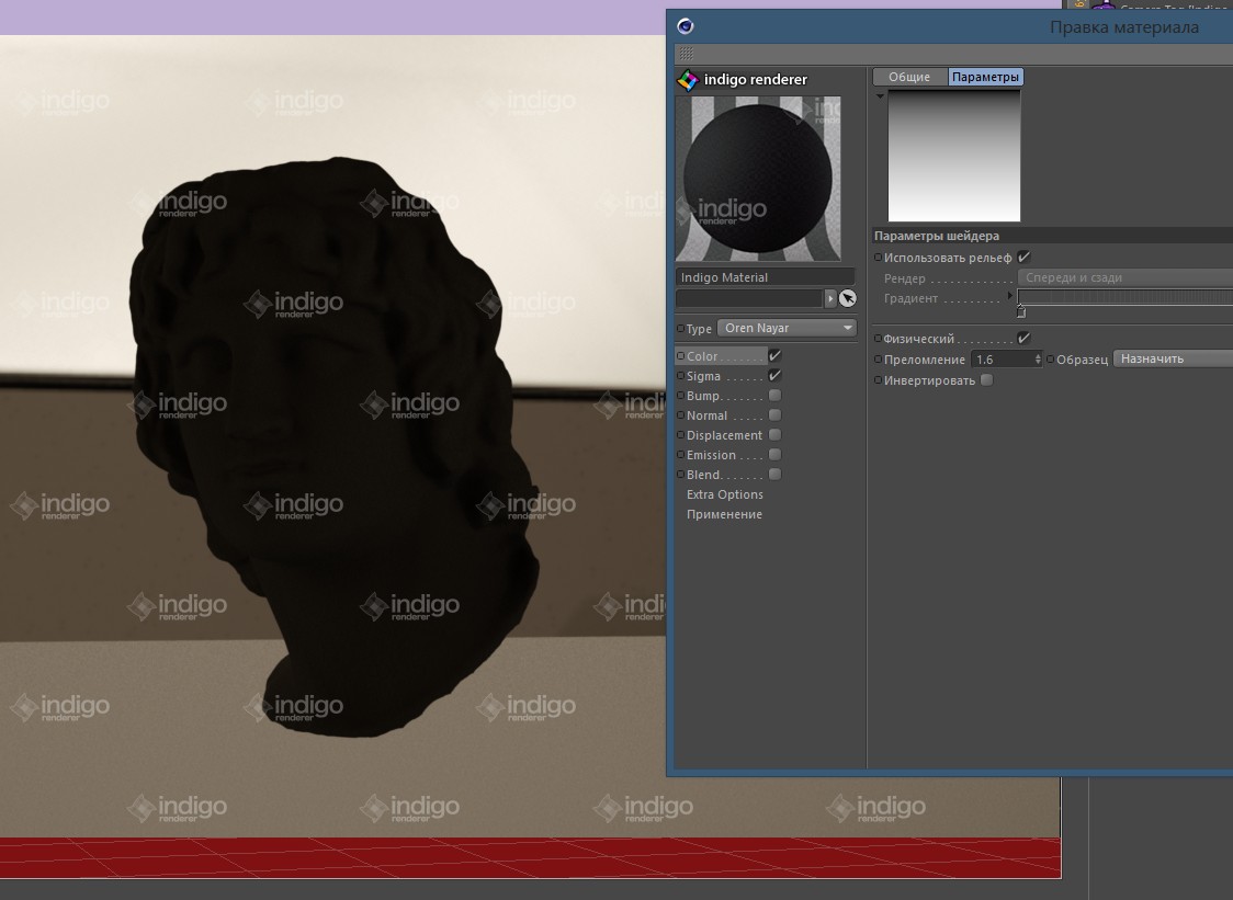

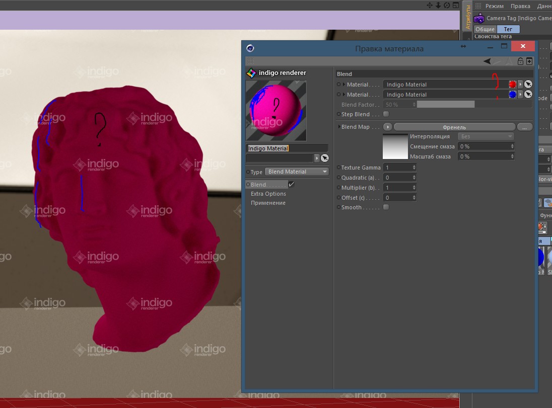

How do I mix the materials through a Fresnel map?
correct operation Freznel.
Fresnel 1.6
Fresnel 1.6_blend

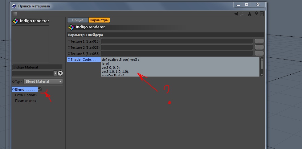

def eval(vec3 pos) vec3 :
lerp(
vec3(0, 0, 0),
vec3(1.0, 1.0, 1.0),
maxCosTheta()
filled in an ISL Shader should do the trick
the both vec3() are the fresnel colors as rgb (1.0=255)
you can now blend your ISL Shader via "ISL Blend Shader" with the desired map or shader of your choice ;)

Many thanks, Mor4us! This topic really has been confirmed and you will do it again. It's really simple :-) But now another question. Is it possible to just mix the textures?

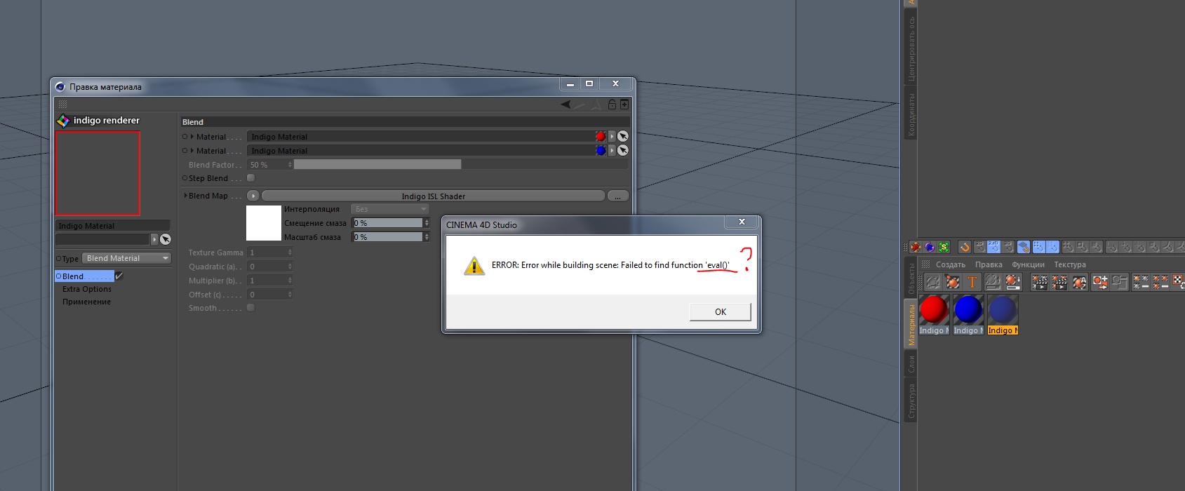

How to fix error?
lerp(
vec3(0, 0, 0),
maxCosTheta()

I think minCosTheta and maxCosTheta cannot be used in a blend shader for physical reasons (it's then easy to break energy conservation). Also, you are using a color shader (returning a RGB vec3) in a blend shader slot (which must return a single number). Both are triggering errors.
So you should not use a blend material for this. Just use a diffuse or phong material, and use the shader in the diffuse channel.
For red/blue just use:
lerp(
vec3(1.0, 0, 0),
vec3(0, 0, 1.0),
maxCosTheta() )
Also, you could use minCosTheta instead of maxCosTheta, the effect will be slightly different.
I personally use 1.0 - pow(1.0 - (2.0/(1.0/maxCosTheta() + 1.0/minCosTheta())), 5.0) as the lerp function
