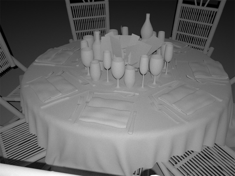

Simply placing a small emitter at the position of the camera (tiniy little higher), and you are done!
Here a quick example using simple Clay render mode:
That technique is usable in actually all render engines...

Perhaps am I not going to model a table set after all o_O
Re: The Question to developer.
He he, its a free model of some Xmas calender from a French C4D community, here is what the containing txt says:
If you want I can send ya the 3D files as OBJ
