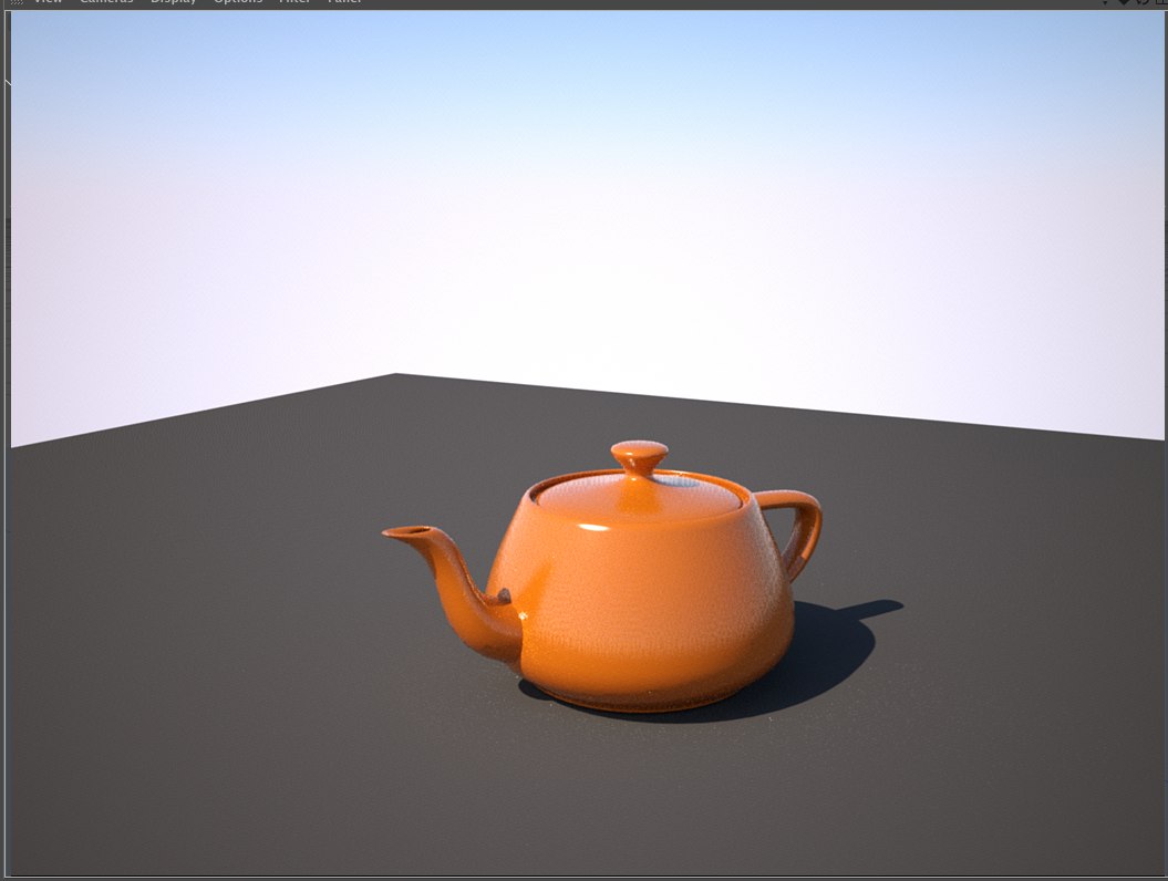

Hi - the test scene you uploaded renders quite alright
this is what I saw straight from your file -

Post by StuDIO » Thu Jul 19, 2012 8:03 pm
ignore me - I havn't has my coffee yet... :oops: (RTFM)
