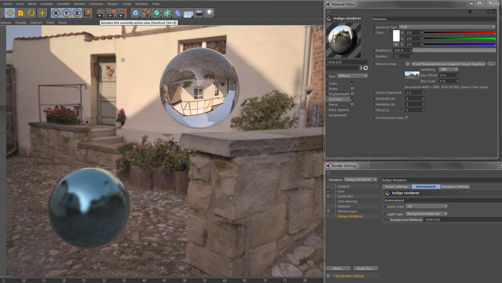

Here's the result and some of my settings:

Where do you change those settings? In the material, I selected Use Emission Scale and Luminance, with a Value of 100000. Then I set the Indigo-tagged camera to use Linear Tonemapping. There was no difference between a Luminance value of 1000 and a Luminance value of 100000. So I figure I'm setting the wrong thing(s).Zom-B wrote:I also would like to second CTZn here, try using for env maps a uniform emission of 10k-100k, its a good starting point for most scenes! Turn your tonemapping to linear or camera, and you'll see
Jeff
Re: HDRI Questions
NVM: I'm an idiot. The last few renders were using the C4D default camera and not the Indigo camera. When I switched to the Indigo camera, there was a huge difference!

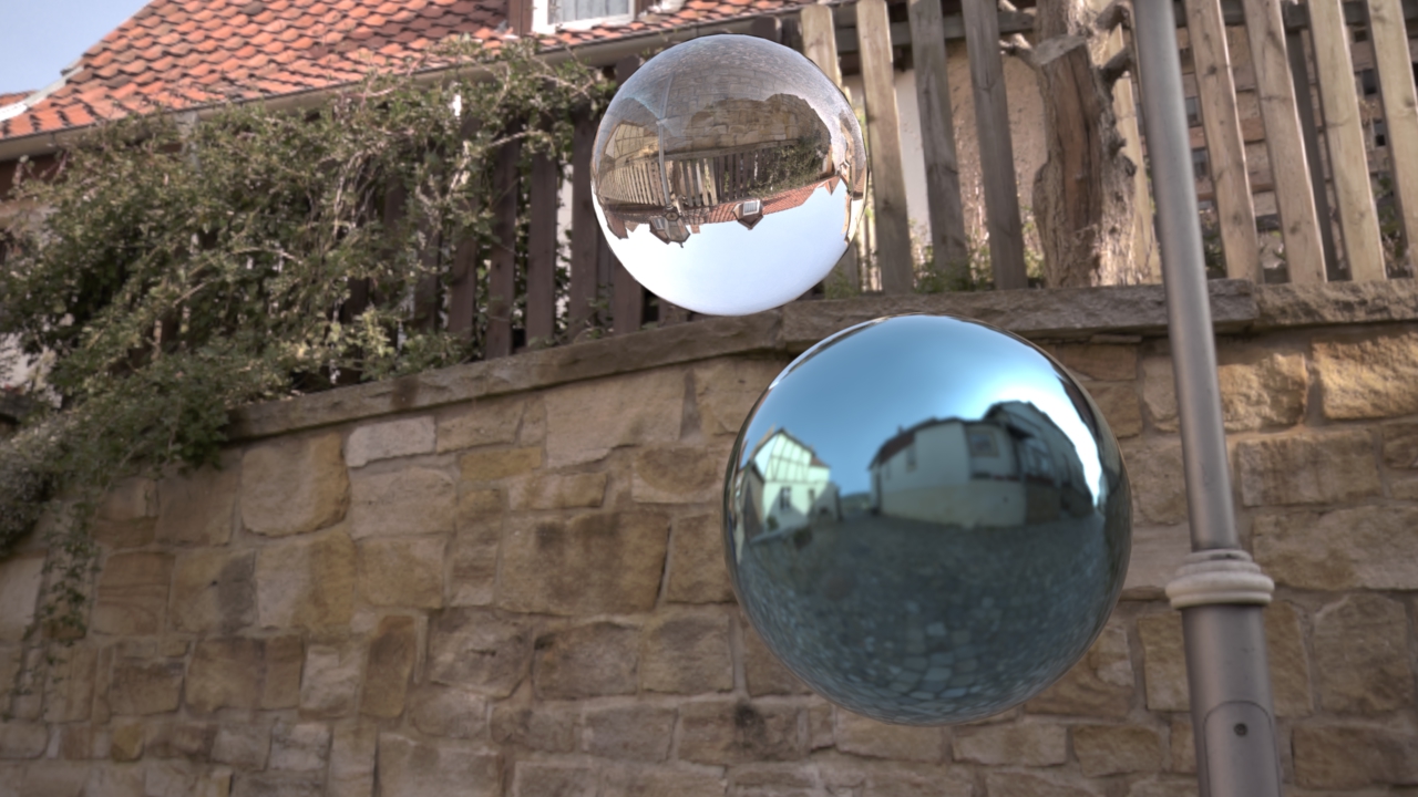

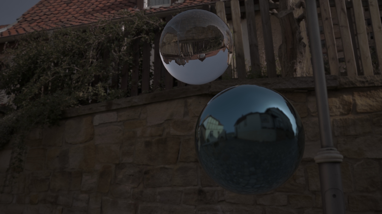

Results of Emission Luminance set to 1k, 10k, and 50k when the Indigo Camera in the scene is set to Linear Tonemapping:
