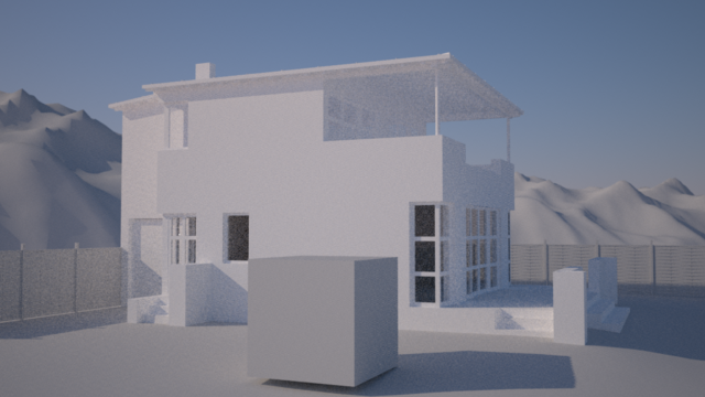

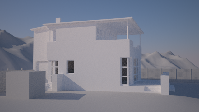

For me the Export works fine, here is the proof of first & last image rendered:
Are you using the MAc version? Maybe its broken there... I'm on a PC.
