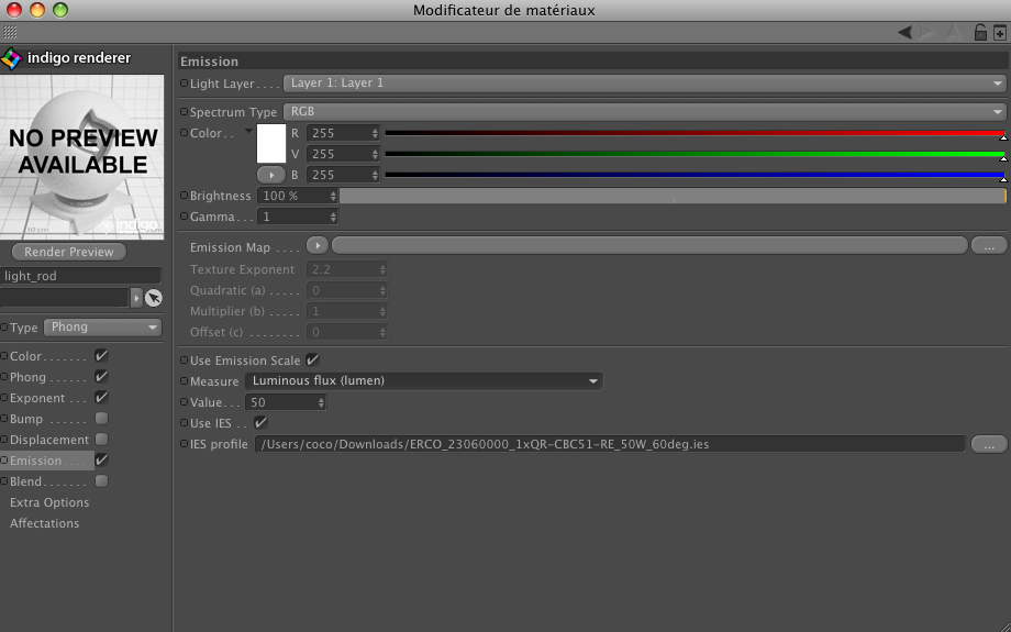

I want to use data IES but I don't know what settings to change.
Should I use the tab "+ IES Lights Scalling" of scattering material? or use the scattering parameters of the material. If so what settings do I have to use (Use Emmis Scale, Value ...)
I did a test on the example, but I can not raise or lower the intensity of light IES.
Always in modifying materials is what I have to specify a spectrum type (RGB, ... Blackbody)
also some "one can tell me the difference between these different types?

Re: LIGHTS IN C4D And USE IES
RGB: Light based on colour and brightness.SCHMUMS wrote: Always in modifying materials is what I have to specify a spectrum type (RGB, ... Blackbody)
merci d'avance
Uniform: A white light with intensity based on value given.
Blackbody: Light is based on the temperature. Measured in Kelvin.
Peak: Define the limits of the wavelength.
Real Tabulated: Allows nearly arbitrary spectra to be defined. The spectrum
value is given at regular wavelength intervals, and linear interpolation is used
to sample at intermediate wavelengths.
There is some hosted IES profiles available from:SCHMUMS wrote:I want to use data IES but I don't know what settings to change.
merci d'avance
http://www.indigorenderer.com/dist/ies-profiles.zip
