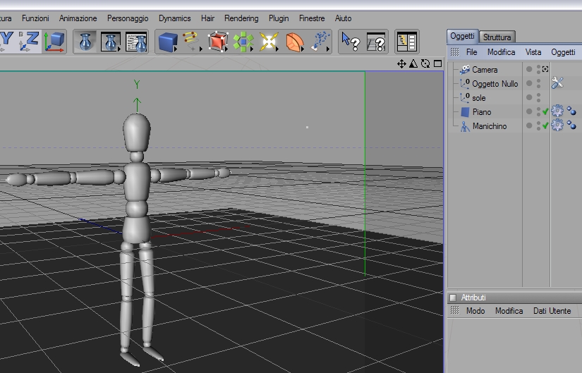

the scene in cinema

WLAD
Posts: 101
Joined: Mon Jun 26, 2006 5:59 am
Post by WLAD » Thu Sep 06, 2007 1:18 am
hi ciccio,
simply conwert the "piano" object to a poly objeckt, or deaktivate the bidirektional rendering. :D

Camox
Posts: 587
Location: Berlin Germany
Post by Camox » Thu Sep 06, 2007 2:00 am
Hi ciccio,
[indigo render settings tag] --> indigo render settings --> render mode --> pathtracing mode only !
then you have disabled bidir !
