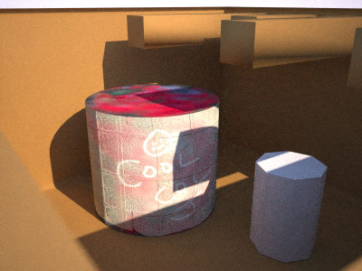

I'm still having to use a negative bump values on that cyclinder even though the normals are facing the right way. Not sure if this is a Cinidigo issue or Indigo one....
so are the phong angle limits read by Cinidigo on export?
does the shutter speed do anything?
smoothing... that structure has smoothing problems, but it also has curved areas, what to do?

did you try to invert your bump map?CoolColJ wrote:I'm still having to use a negative bump values on that cyclinder even though the normals are facing the right way. Not sure if this is a Cinidigo issue or Indigo one....
no, not atm, its tricky.CoolColJ wrote:so are the phong angle limits read by Cinidigo on export?
yesCoolColJ wrote:does the shutter speed do anything?
re the bump map, well it renders fine in C4D, as it comes from Bodypaint, I did bump and colour together
funny thing is - I used the same bump map on the brown structure and it inverted on that with C4D, same thing in Inidgo, so Indigo and C4d are inverse to each other
