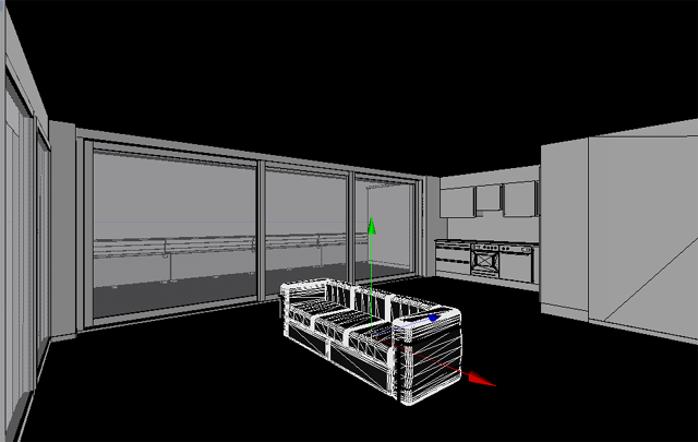

Is this the typical xyu coordinate bug ?
that happens to me if I import a sofa from another c4d scence (see attached files).
is this the typical xyz coordinate bug ?

Re: Is this the typical xyu coordinate bug ?
Hey Alain... it seems you simply ignored my advice to take a look at the Buglist I told you about in your previous thread...Alain wrote:that happens to me if I import a sofa from another c4d scence (see attached files).

I just connected all the elements of the sofa with the same material to one polygon an now it works without manipulating the igs file

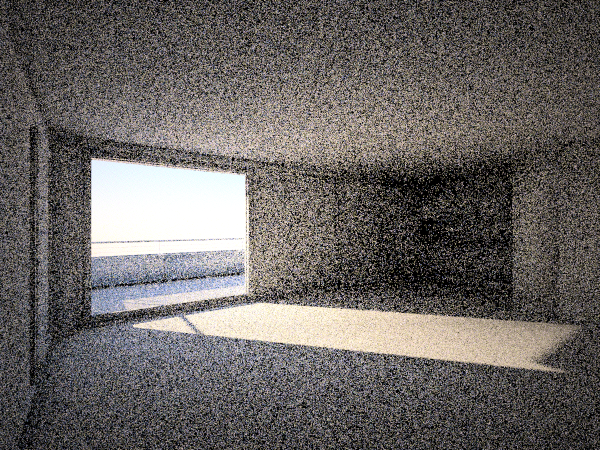

one thing that I didn't find out yet is how let the sunlight trough the glass without scattering it. there should be hard shadows of the woodelements of the window but as you can see they are not there.
which paramaters do I have to change to let the sunlight in an getting hard shadows inside the room ?

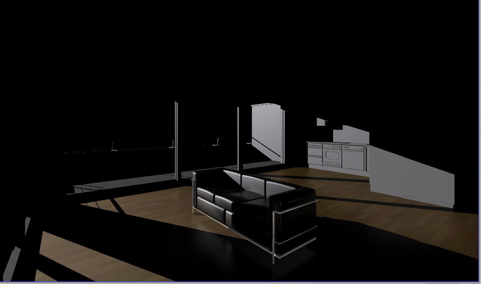

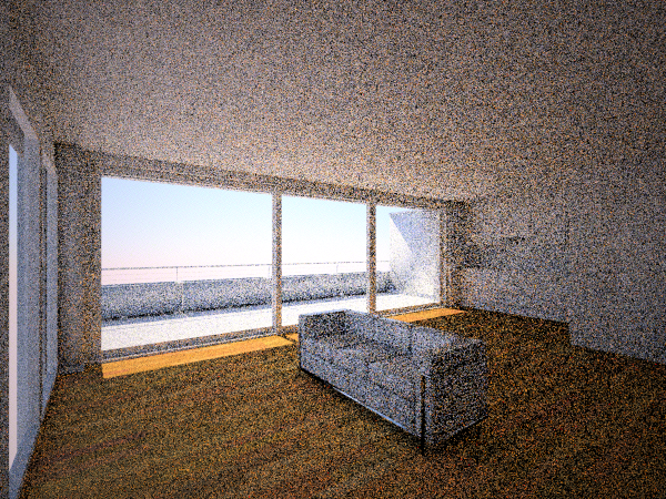

I removed the glas and the sun comes in now. but from the wrong direction (see attached files). in some earlier renderings the direction of the sun was correct, is this because of the xyz coordinate bug ? I set the axis of the nullobject of the sun to zero like marcofly told me, but that doesnt help at all for the sun.
I would like to add some reflection on the glas as well, so I don't want to remove the glass.

@manitwo
the picture "im1188145453.png" is without the glass.
in one of my first test renderings the sunposition was exactly the same as it is now but I had no glass material there yet, I just removed the glass polygons (see attachement).

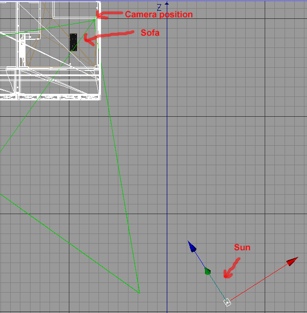

I used a spotlight (you mean in cinema ?) and tried to link it as a sun in the cindigo render settings tag. that's what you mean ? but its not possible to link light objects in the cindigo render settings tag.just try with a spot light->link active object, and see where it points!

in C4D: create a spotlight, then go to the 'perspective view' panel, click on Cameras->Link active object. now your camera is linked with the spotlight. move it till you're satisfied with the result, then put a Null Object at its place, and delete the light. this Null Object will be the sun!
this is the easiest way to be sure about your sun-position..

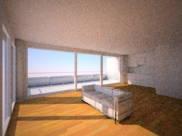

ok, I found out if I just move the null object for the sun a bit more left, the angle of the light gets better (see attachement).
anyway the angle of cinema 4d light is not the same when I use its position for the cindigo sunlight. But I still don't understand why it was correct in my very first rendering tests..
