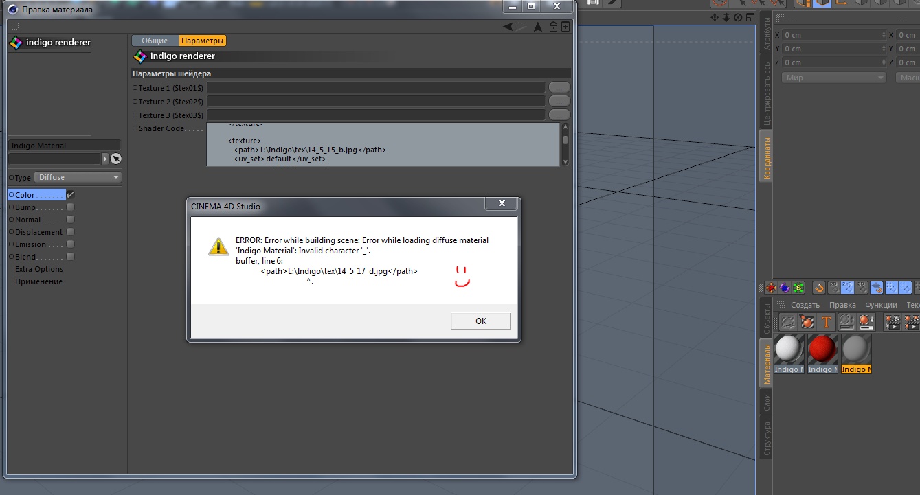

what did I do wrong?

error
Re: need help with Cinema4D fresnel
Post by Zom-B » Thu Apr 11, 2013 2:32 am
N.G. wrote:what did I do wrong?
You've put IGS code into the ISL Editor :)
Only put that code into the editor:
def eval(vec3 pos) vec3 :

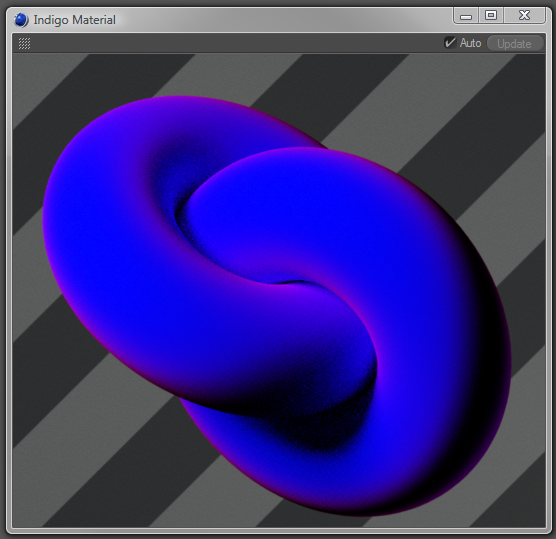

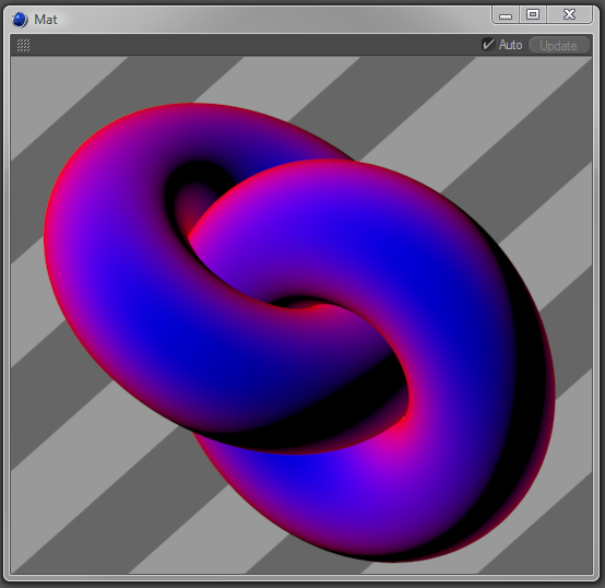

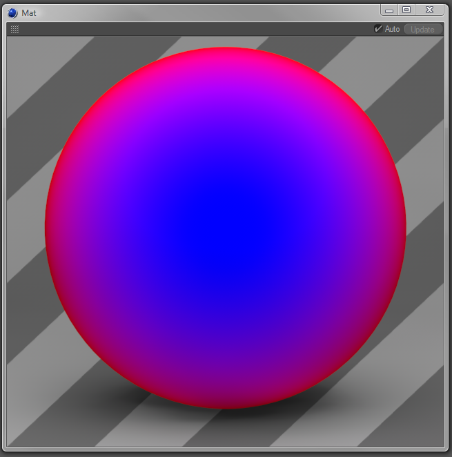

The Problem about minCosTheta Ono is that the result isn't fresnel but something else...
Indigo minCosTheta()
C4D fresnel

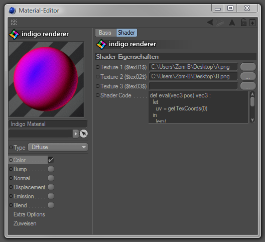

Post by Zom-B » Thu Apr 11, 2013 2:48 am
Here you go:

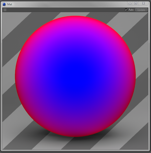

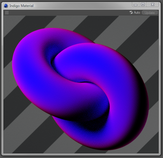

Post by Zom-B » Thu Apr 11, 2013 4:02 am
Thanks for the code galinette, its better then pure minCosTheta().

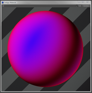

I attached example of fresnel vs ISL
galinette wrote:1.0 - pow(1.0 - (2.0/(1.0/maxCosTheta() + 1.0/minCosTheta())), 5.0)
or
1.0 - pow(1.0 - (0.5*(maxCosTheta() + minCosTheta()), 5.0)
The bottom example misses a ) ;)
N.G. wrote:Why should I to score a head program codes? need to make everything easier!!
THANK YOU ALL! :D
Its NOT about coding at all here, JUST the knowledge what values to EDIT!!
I also don't understand ISL code at all!!!!
here is the code I used for the example, the bold number is the strength of fresnel, value of 1,75 seems to be a good start.
let
uv = getTexCoords(0)
in
lerp(
sample2DTextureVec3(0, uv),
sample2DTextureVec3(1, uv),
1.0 - pow(1.0 - (0.5*(maxCosTheta() + minCosTheta())), 1.75)

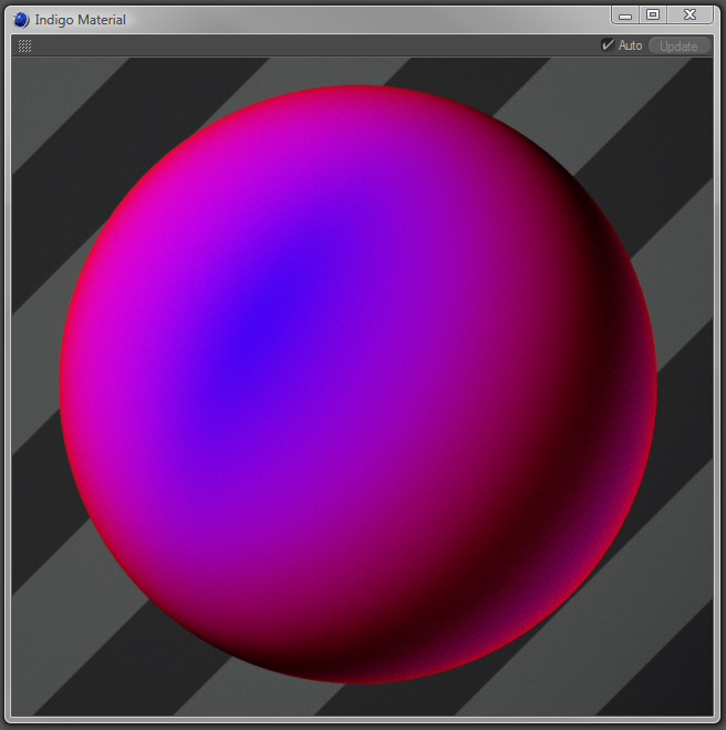

I attached also a example with value of 3 just to show you the result.
OnoSendai wrote:
galinette wrote:However, none is 100% identical to the one used in most softwares, which use the cosineTheta of the halfway vector, which is not available in Indigo (subliminal message to Ono ;) )
Good idea :)
Would be sweeeeeet!!! :D
Indigo with value o0f 1.75
Indigo with value of 3.0
C4D fresnel
