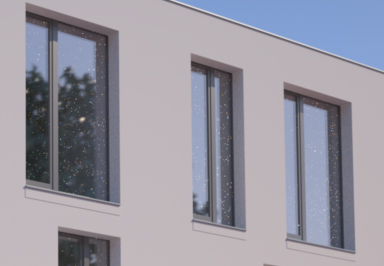

Hello,
i have a Problem with Version 2.2.12 and Cindigo 2.2 Stable
I habe a sun, (Infinite source) and a Glass-Material (Ghost-Glass from Download)
On the Glass are white points, This Points are not rendert in Version 2.2.1, he comes with the new Sun-Def
in the new Version. The points lie on the light layer of the sun. Layer of --away points...
U can see the points at the Picture--- what can i do?
Rendertime: 18 h at 4x E7 Cip, 6 GB Ram
Thx,
Frank

Re: Problems with sun and Glass in V2.2.12
Strange.
In which units did you model your scene, and what is your scene scale in the exporter settings?
And in which render mode did you compute this? Path-Tracing, Path-Tracing Bi-Directional, MLT or MLT Bi-Directional?
the ghost Glass from the MatDB needs Single sided mesh... normals facing to the cam, is this given here?
Do you render in PT mode? Try MLT+BiDir... should render just fine!
In this scenario I would use "normal" glass (with thickness), should render fine here
Hello
Thank you for your responses. It is up to the Render Mode
The Render-Mode MLT has no more white spots.
Thank you very much
Thank you very much
