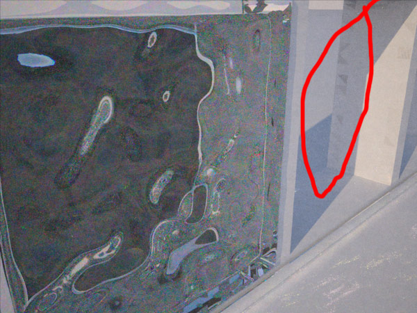

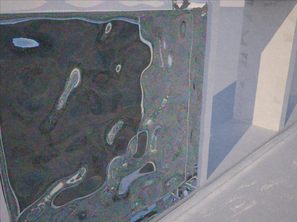

I've done a [(1x4)x8] array, but due to it some are instances of instances so, as you can see, anything beside the original one do not render.
What should I do? A 4x8 array, or is there any way to do this kind of array?

Yes, Instances of Instances don't work atm, but you can simply select all your not rendered instances, and change the source of instancing to the base mesh... done!

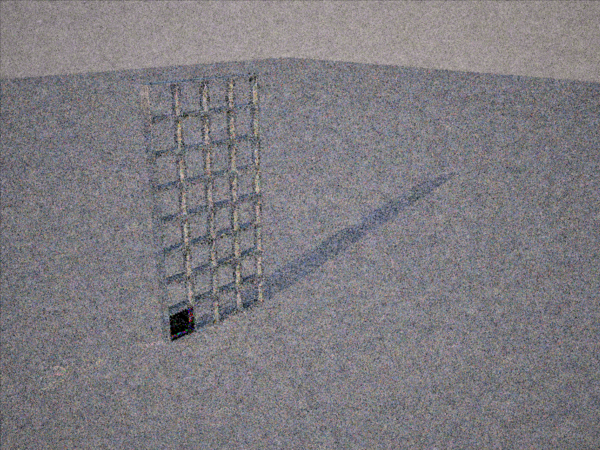

You can also take the base object, >duplicate it 3 times (with 'generate instances' unckecked), so you have the first lower row of objects.
Then put the base obj and the copies in a group, select the group >duplicate ('generate instances' marked)..

why do you still have those triangles visible? they shouldn't be there! check the scale of your project, or post the window so we can have a look at it..
Indeed that was the only way I thought of, yet the forum had eaten my post a few times already as such I add not expressed myself fully. I wanted to avoid it too because they are heavy objects even if only one. BTW, which triangles?
Post by Zom-B » Sat Feb 02, 2008 4:53 am
pixie wrote:BTW, which triangles?
This ugly guys here!

Well these are to be close ups and to influence the overall scene so I put as much detail as humanly possible...
New version

pixie, it's always a compromise between quality and time.. sometimes there are scenes where everything is perfectly cleared, and 1 element still has noise after 30 hours rendering.. well, i prefer to find a roundabout for that object, instead of waiting so long..
The attached pic has an incredibly low poly count, clears the transparency at 250k samples\second, and IMO doesn't look so bad, at a certain distance.. (the bump could have a smaller tiling, but it's just a test..). After 5 minutes rendering i achieved 100 samples\pixel @1000x1000..
