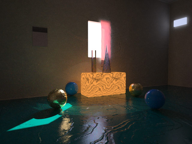

here is a simple sample scene for the people that wanted it.
created for Indigo V0.9. Use test 7 for best speed
There is a bit of everything in this scene except SSS, which is slow so I left it out, but the scene will take a bit of time to render anyway due to the interior light. It will render faster if you remove the light.
And 100 ray bounces used to keep things a little faster, but will probably be more accurate with 1000 bounces or more.
V0.9 test 7 is pretty quick compared to before anyway 8)
some notes
1) Objects from left to right -
-Mirror, specular with IOR of 100
-Gold sphere using Nk data
-diffuse box using the floor bump map for colour and bump as well :)
-glass/specular cylinder with some dispersion (Cauchy_b)
-cone glossy transparent
-Window exit portal object
-"Curtain" with diffuse transmitter material - normally I would blend it 50/50 with a diffuse/phong material as well to give it some colour, but the blend material is currently not working for me in Cinidgo. Will update when this is fixed.
-reflective Phong sphere
- mesh light with fluorescent light type settings. Also using Efficacy scale to make it work properly with the sunlight
2) The Global scale is set to 0.01 to set scene scale to proper size for Indigo's metre units, since the scene C4D units are in cm.
This is important for the lights (efficacy scale) and rendering to work properly.
this also means glass/transparent object won't have as much colour, unless they are very thick. Until we get a absorption value/colour multiplier in Cindigo there is not much we can do.
3) gamma value of 2.2 used for the transparent objects - cone and cylinder to match the C4D colour, otherwise you would normally use a gama value of 1.
4) Autofocus is on, but it's normally better to turn it off and manually set the camera depth to where you want it to focus on, especially if you increase the aperture size to add more depth of field
pic - will update with a cleaner version when I render it for longer :)

Post by CoolColJ » Mon Oct 01, 2007 2:39 pm
OK I have a revised version of the scene to use all the new features of the current Cinidgo! 8)
I'll change the description to reflect the new scene, but for now here are the change notes
works fine and best with V0.9 test 7
and exit portal actually works now! Big difference in render speed
1) changed all the names for materials and objects to make everything more clear. And changed the render settings to my new optimal settings
renders quite a bit better now. It will look really ugly and patchy at first but it smooths out and cleans up much faster with more detail.
2) reduced Cauchy_B (dispersion) on Specular glass cylinder from 0.1 to 0.01. Nothing else has changed but it renders differently now, I think due to the textured emitter underneath
3) added SSS on Purple glossy transparent cone, uniform scattering. Quite a lot of scattering so it looks more solid than transparent now in the thicker areas.
4) "curtain" is now a blend material of 50% diffuse texture for the pattern/colour and 50% diffuse transmitter for colour transmission and transparency.
I created 2 copies of the object as child objects and assigned
the 2 different layers to each. These objects are disabled so won't get exported, but you can enable them as needed to preview the layers individually in C4D or Indigo to setup the textures or whatever properly
5) changed the Box to a textured emitter with a higher efficacy to give it a glowing look in the presence of sunlight
6) Gold Phong NK material sphere now has a large amount of bump map
7) Blue Phong sphere now has exponent mapping using the tetxure in the specular colour channel. Unfortunately you have no control over the exponent gain in Cindigo for now. Set the material exponent for the lowest level and the map will add 10,000 over that for the brightest colour of the texture map
8 ) Added instance objects for the 2 spheres. Indigo will render these using the same models of the original (and same materials in the current Cindigo) where ever you place them
LOL I used the same texture for all objects :P
CCJ_C4D_INDIGO_SampleScene_V2.zip
created in C4D r10
(281.28 KiB) Downloaded 547 times

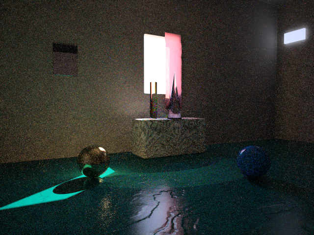

preview - 400 samples

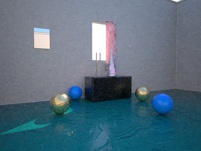

Post by CoolColJ » Mon Oct 01, 2007 9:44 pm
removed the roof and turned the ceiling into an exit portal
changed some materials and rendered up to 100 samples. You can get some good mileage out of one texture :D
You can see the diffuse texture/diffuse transmitter blend material curtain better here
Post by Kram1032 » Tue Oct 02, 2007 2:08 am
very nice :D
why did you turn off the textured emitter, again?
Or is it simply too bright to show up?
CoolColJ
Posts: 1738
Post by CoolColJ » Tue Oct 02, 2007 10:17 am
I didn't like the look of it under skylight :)
and yeah it was a bit dull looking
