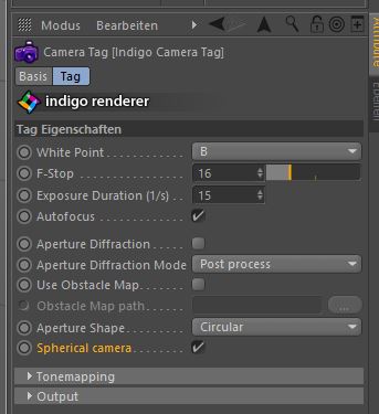

As a preface, I've recently decided that I need to significantly reduce the overhead of my render scenes. All of which include anywhere of 50-200 objects not including human/humanoid models. I also have a personal policy of never using a texture map below 2k on anything that's six inches or larger in any measurement. That's something I refuse to compromise on. So I've been figuring out what I should do, and I came up with a solution. Render indoor/outdoor environments in a manner that I can use the renders as HDRI maps for image-based lighting and backplates.
My problem however, is that I'm not sure how to approach achieving a 360 degree panorama... I'd really really good to do it in render in order to save from having to do so much post-processing work stitching images together. (Plus, no matter what software I use I can never get anything to stitch into anything that remotely resembles an actual environment.)

Post by Zom-B » Tue Apr 21, 2015 3:23 pm
Enjoy :)
