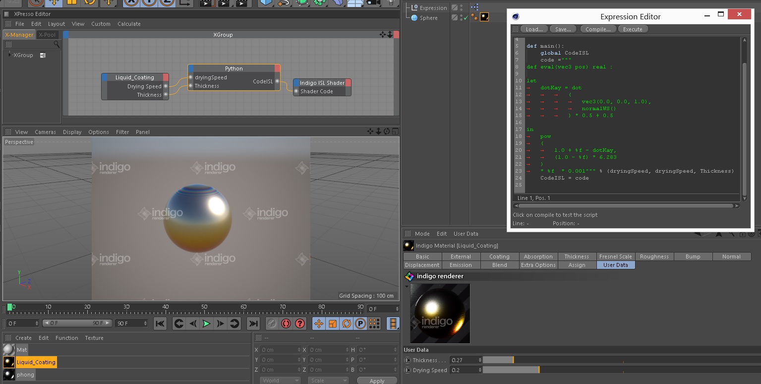

There is small help to control parameters in cindigo isl.
go to user data of mat and you can to control additional options as Thickness and Drying Speed
Prototype based at CTZn's material - Liquid Coating
Isl_Python.zip
c4d scene - c4d r16.021
(85.98 KiB) Downloaded 371 times

This is quite smart, animated ISL Shaders :shock:
First thing I thought of here is a water material for a pool using ISL Noise, that has some subtle movements...
Thanks a lot for sharing this!

Another way - python tag
based at http://www.indigorenderer.com/node/1945
fused, thank you, nice for waves
p.s. mat[c4d.INDIGO_MATERIAL_THICKNESS] - this part you don't need
I'm sorry for my bad English

Post by Ilay » Fri Sep 19, 2014 3:51 am
I do not do it :oops:
fused and CTZn made, i only add control gui by simplest way

Your approach opens a tighter integration of ISL into C4D!
