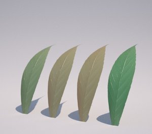

I have some texture of the leaf. I need to change its tone. For example, with the RGB (250,127,127). I do this in three ways, and get different results. Textures from right to left:
1. Main texture.
2. Mixed by Blend material with RGB (250,127,127).
3. Mixed through the layers of C4D.
4. Mixed through the layers of Photoshop.
I especially do not like the difference between the third and fourth textures. Is that correct? Or is it a bug in Indigo?
regards..
texture test.rar
attached C4D file with textures.
(587.28 KiB) Downloaded 404 times

wlf_alex wrote:I have some texture of the leaf. I need to change its tone. For example, with the RGB (250,127,127). I do this in three ways, and get different results. Textures from right to left:
1. Main texture.
regards..
If the fourth one is a photoshop mix of the main texture with a red color (250,127,127 is red), it should not be greener than the main texture.
Also, Indigo mixes in linear space while photoshop mixes in gamma (srgb) space. Hence the result which are necessarily different.

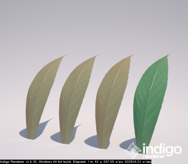

I think that this is a problem converting materials. In C4D all three versions of this material have the same effect. But Indigo gives different results, perhaps because the Indigo does not support all the shaders C4D. But then where do I find out exactly which shader support Indigo? And what a way to correctly to paint the texture in Cindigo?

Re: Tint of the texture in C4D. Mistake or not.
Post by Zom-B » Tue Apr 16, 2013 6:19 am
wlf_alex wrote:But then where do I find out exactly which shader support Indigo? And what a way to correctly to paint the texture in Cindigo?
Cindigo bakes each C4D Shader, you can doublecheck that resulting texture, it gets saved in the same folder where you export your IGS to do a external rendering using Indigo GUI version.
If you could also upload the c4d file we can have a look at it too!
Post by Zom-B » Tue Apr 16, 2013 7:32 am
wlf_alex wrote:Thanks for the reply, Zom-B ! I added C4D file in the first post.
Your red materials has set brightness to 80 in the diffuse tab.
By that you reduce your 250, 127, 127 material to 200, 102, 102.
Here the render after "fixing" that:
BTW: for such materials turn on "Step Blend" Checkbox for faster rendering ;)
Using that Indigo clamps pixel information to full black or full white, creating a "sharp" blend mask.

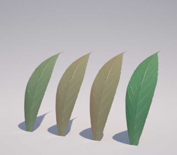

Post by galinette » Tue Apr 16, 2013 8:39 am
And this is what I got after the change suggested by zom-b and doing the photoshop blend in linear colorspace instead of gamma colorspace:
You can see the strong effect of blending with different colorspaces by downloading this PS file
AM106_023_color_leaf.7z
(206.55 KiB) Downloaded 379 times
, and going to Image>Mode>32bit/channel, and choose "Don't merge". If you then merge and go back to 8bit mode, by using "Local Adaptation" with Exposure=0 and Gamma=1, you get exactly the same results as Indigo. Technical explanations are possible if some are interested....
