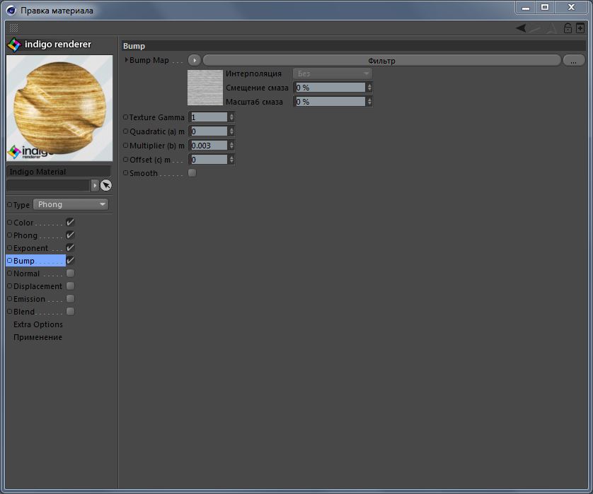

decided to do to set up the materials - a preview.
Here's how to configured scene for this:
-At the beginning of configured through EXR. when attempting to run the preview error has occurred - no light.
-In the preview does not display anything. no background, no environment.
-In a last attempt to make a scene, lit by two light sources. The result - I am sad.
here so configured a preview.
here so shown in the program.

last attempt. (illuminated by light cone)

-have the opportunity to sew in the scene settings INDIGO? and under what the parameters working of the standard viewing of materials? I wanted to sew in number of samples render, but not coming out.
-How can illuminate only preview EXR? or for this is to rewrite the connector?
