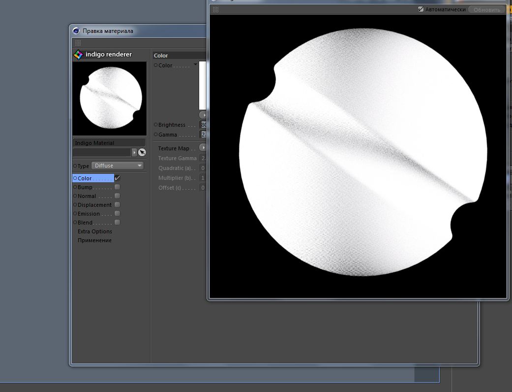

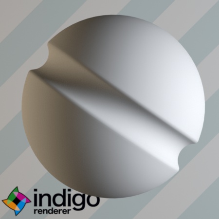

decided to do to set up the materials - a preview.
Here's how to configured scene for this:
-At the beginning of configured through EXR. when attempting to run the preview error has occurred - no light.
-In the preview does not display anything. no background, no environment.
-In a last attempt to make a scene, lit by two light sources. The result - I am sad.
here so configured a preview.
here so shown in the program.

Post by N.G. » Tue Dec 25, 2012 10:03 pm
last attempt. (illuminated by light cone)

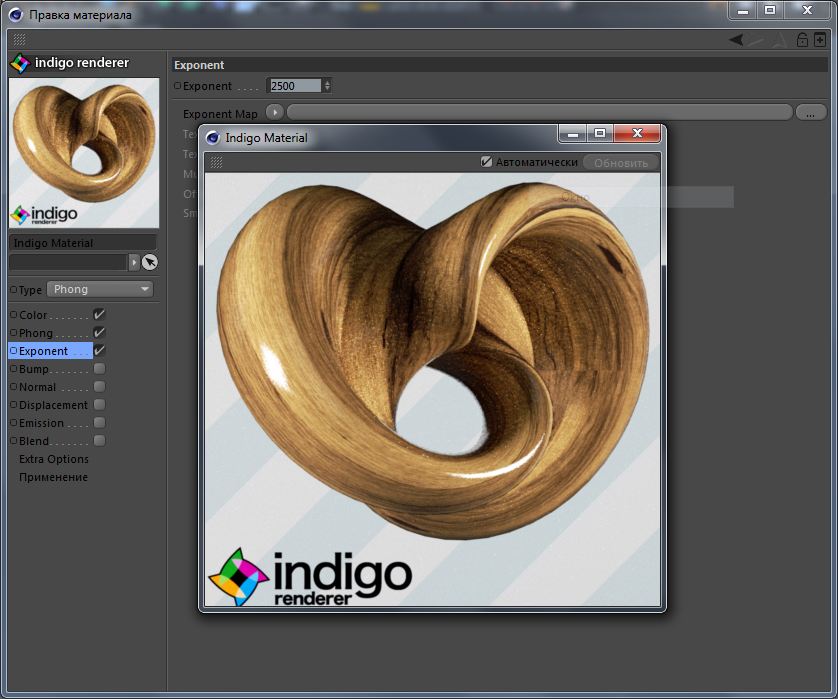

Post by N.G. » Fri Dec 28, 2012 2:19 am
Final lay out here.
