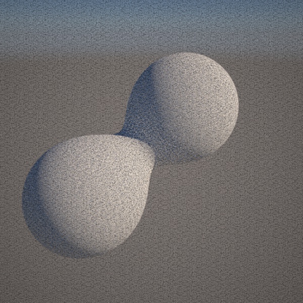

Re: How can I create motion blur in Cinema4D?
The MoBlur System has an limitiation, that only movement get takes into acount, not any polygonal morphs like meta balls etc.swampdigo wrote:I'm super keen to have a 'if it moves on my screen then Indigo can motion blur it' result
But there is a nice workarround for that
You can enable Scene-MotionBlur in the render settings and render a image inside C4D!
You also need to set a halt parameter for Indigo to get it to work.
C4D then renders as many subframes as you told it to do and merge them into a image.
The great thing here is that the renderquality gets merged to, but MotionBlur tags on objects get ignored.
rendering 15 subframes with halt @ 10sec you end up with a nice 150sec look of the final image
(not perfectly true, but a solid base to work with)
Here are two renderings of a 49step motion with each rendered to only 2samples/pixel. the noisy image is to show how a render of 2 s/px look like
