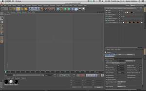

I am new to this forum and Indigo Renderer. I have had a go and got some reasonable results so far using C4D :D
I do have a question though, I took a scene I has made, imported materials from this site and applied them to my model - which promptly disappeared. At least it did in the view port. This confused me (doesn't take much though).
I am wondering what I did wrong?
I am using C4D R13, on a macbook pro 2012.
Thank you for any help you can give!

Not sure what exactly is going on.
This is definitely related to assigning an Indigo material to the model?
If you remove it from the model, does it reappear?
Can you make a simplified scene for me that shows this exact problem?
Cheers!

Did you activate Advanced OpenGL in the viewport?

The problem is definitely to do with the materials - if I delete one or more the bit that are not assigned a material reappear. I didn't activate Advanced open GL. It happens if I set the render to the standard render too.
I have tried to replicate it on a simple cube and that disappears too with the same materials...? If I create a new material, that seems fine.
The object is clearly there when you click on its name in the objects manager, but as soon as I click away, poof, its gone!

poodles wrote:The problem is definitely to do with the materials - if I delete one or more the bit that are not assigned a material reappear. I didn't activate Advanced open GL. It happens if I set the render to the standard render too.
Ok, weird :)
Can you upload the scene file or email it to support@indigorenderer.com?

ah...i didn't think of that! here it is. When I change the materials the model reappears..

poodles wrote:ah...i didn't think of that! here it is. When I change the materials the model reappears..
Ah, ok that sounds like a familiar bug :)
Since R13 (I think) the editor representation of the material does not update immediately for some reason. Looking into it :)

Ive noticed it takes a short time to change when I change materials from c4d ones to indigo renderer ones, but these are indigo materials downloaded from this site.
