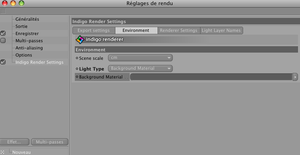

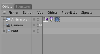

Fused Hello, thank you for your help, but it does not work. This is what I do:
- I create in my c4d scene as an object back plan
- I create a new material in the channel luminescence I load a HDR.
I assign this material to the object plane back I add a tag light.
After trying to glide through the Environment tab of the preferences Indigo renderer but it does not work.
I attached the screenshot.
thank you in advance

Re: Physical sky on INDIGO
as for me I found I was not as it should. However I have a problem I've encountered several minutes ... there is a demarcation in the middle of the image, how to address them. Thank you
