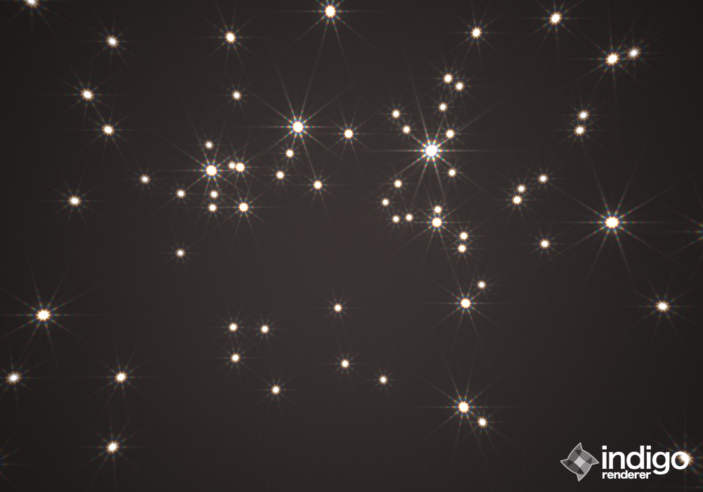

Post by Zom-B » Fri Jul 24, 2009 1:24 am
here a quick test:
Re: Indigo 2.0.11
Post by suvakas » Fri Jul 24, 2009 1:54 am
ZomB wrote:here a quick test:
Did you made the scene like that. Is it expected behaviour? =)
Re: Indigo 2.0.11
Post by Zom-B » Fri Jul 24, 2009 2:21 am
oh yes it is... just a field with 100 emitting spheres and a cam with small aperture size + obstacle map!
At the moment I only have problems to get this working with image based lightning... like envMaps (and envMap reflections!) :/
Ono, before I continue testing... does this work with image based light anyway??

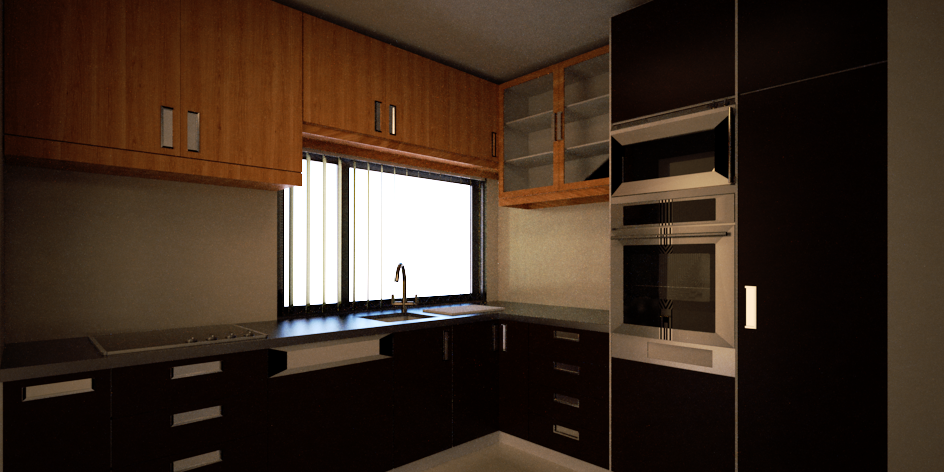

Post by pixie » Fri Jul 24, 2009 11:50 am
A perfectly fine scene render useless by 2.0.10 :(
Also the same problem on 2.0.11
bug.zip
(166.16 KiB) Downloaded 392 times

Post by OnoSendai » Fri Jul 24, 2009 1:23 pm
ZomB wrote:Hey Ono, here you got a "Crash & Burn" scene file!
Zom-B: You're an Indigo-crashing machine, aren't you :)
The bug was with the one-component obstacle map, have fixed for next release.

Post by OnoSendai » Fri Jul 24, 2009 1:27 pm
Pixie:
I investigated the bug you are referring to. It's a self-intersection issue.
I tested out a possible fix, to make the intersection a little more robust. Unfortunately, it slows down rendering speed by something like 3%-10%. So I'm not sure if it's a good idea to include, seeing as most scenes render fine.
I think you are seeing issues because your model is quite large - larger than it should be (if one unit = one metre) , and not near the origin of the scene.
I'm still investigating this issue, so any feedback or thoughts are welcome.
