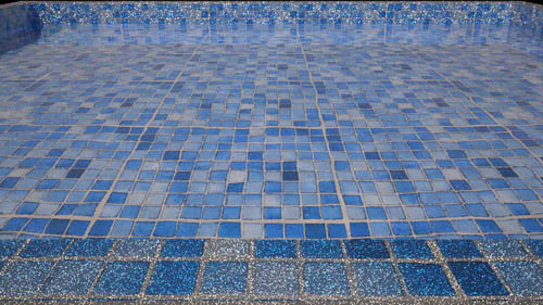

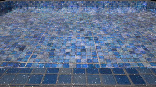

It also seems that specular material stilll don't like touching phong materials.
I did a long time render on 0.9t9 and in 1.0.1 it seems to become messed up the same way.

Indigo 1.0.1 rendered for 10min -scaled down to 50%
Indigo 0.9t9 rendered for 5.40h - scaled down to 50%
