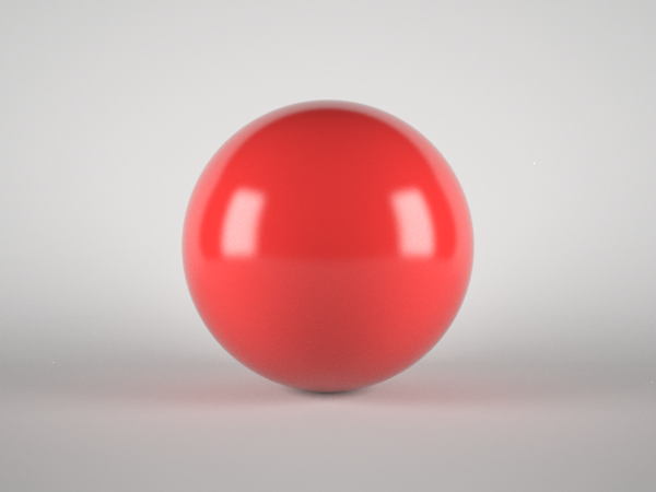

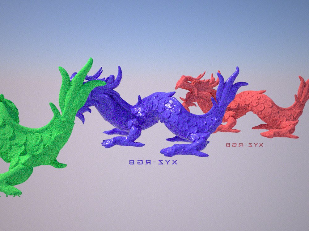

I've attached a couple of images,
a nice shiny red sphere (~10 Hour render time :wink:),
and a scene showing off the new RQMC and BIH code: the scene with 3 XYZ dragons (7.2 million tris each) rendered for about 6 mins, and loaded up in about 40s.
