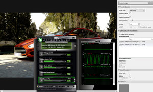

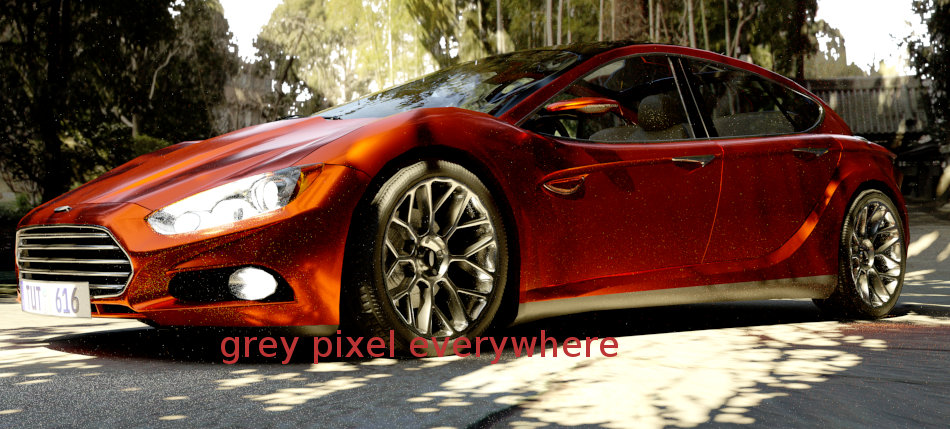

I'm a little bit disappointed by the Indigo 4.0.48:
-> There are grey Artefacts everywhere.
-> he does not export the light layers from Cindigo
-> in Cinema4D (R18), he does not support any GPU anymore...
-> The biggest disappointment: No GPU in BiDIR MLT :-(
-> I don't understand with enabled Open CL rendering, why he does not support GPU and CPU both alltogether 100%. GPU is often very interrupted, when uploading samples. In the pure GPU, this works much better, but then, CPU is not completely used...
But 6m7s, where Indigo 3 tooks 1 hour and 3 minutes :-) Has a lot of potential perhaps with an After-Effekt Filter or s.th. like that...
...I'm very keen that you go on in the developement... ;-) !
GPU is interrupted while CPU is supported good. This Render mode is not so fast (9m 11s) like the pure GPU (6m 7s)...
Grey Pixels like Artefacts since Indigo 4...whaaaaaat
Last edited by JH-CAD-Architekt on Thu Mar 30, 2017 8:32 am, edited 1 time in total.
Re: Indigo Renderer 4.0.48 Beta Release
Post by Oscar J » Thu Mar 30, 2017 8:13 am
Those are just fireflies I think?
