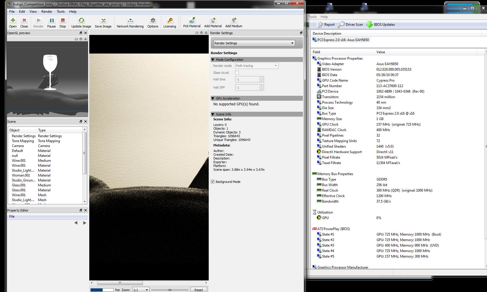

This release is not better for my Asus EAH5850 DirectCU (HD 5850 1024 MB)!
It says that no support GPUs are found. Maybe a Problem with OpenCL? I installed the AMD APP SDK v2.4 with OpenCL support from here:
http://developer.amd.com/sdks/AMDAPPSDK ... fault.aspx
and Catalyst 11.6 but GPU-z says that opencl is not supported. My card should definitely support openCL but please look a the screenshot.
Has anyone else made some experience with ati cards?
Re: Indigo Renderer and Indigo RT 3.0.14
Hi vasco,vasco wrote:This release is not better for my Asus EAH5850 DirectCU (HD 5850 1024 MB)!
you dont need to install the APP SDK.
If GPU-Z also reports that OpenCL is not supported, it sounds like this is a driver issue.
