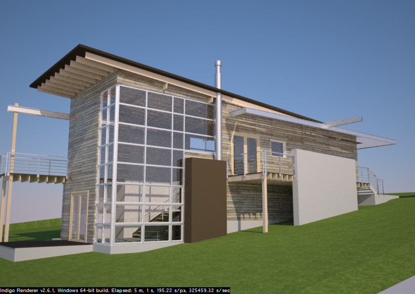

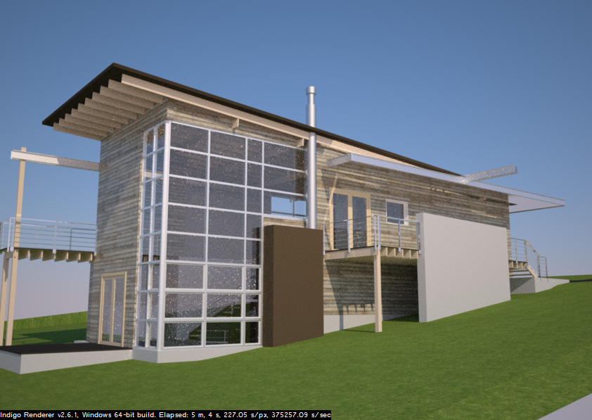

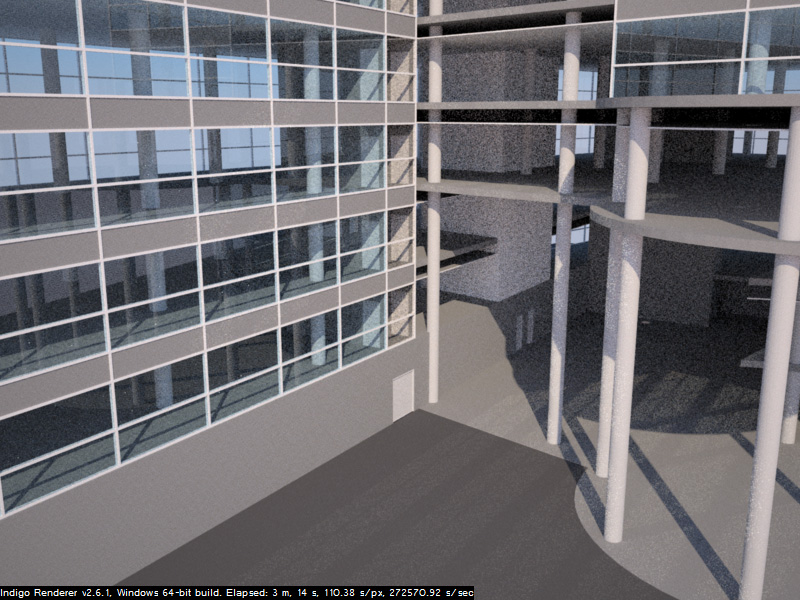

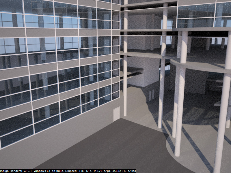

Results
You can see some results using Architectural Glass Acceleration below - each scene is rendered first without glass acceleration, then rendered with glass acceleration for the same period of time. Architectural Glass Acceleration allows the sunlight illuminating the interiors through glass to resolve much faster.

Results
