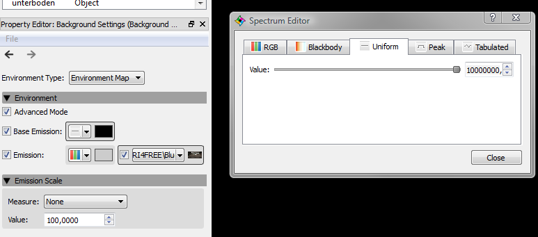

Simply don't use any emission scale for the EnvMap at all :)
I use uniform emitter with value of 10.000.000 is what I do all the time for EnvMaps!

Pibuz wrote:In Skindigo, if I use an EnvMap I MUST specify an emission scale.. :( lumens, candelas, nits or lux
Then Export it and change the settings in Indigo GUI ;)
Re: Indigo Renderer 3.6.9 Beta Release
Post by Pibuz » Mon Apr 08, 2013 4:58 am
Ohh I see!..so I guess that value pushes DOWN the effective power of the EXR map, so that the other emitters can clear faster.. Is that correct?
..If that value would still be to much, I'd have to push it down some more?
Post by Zom-B » Mon Apr 08, 2013 5:16 am
Pibuz wrote:Ohh I see!..so I guess that value pushes DOWN the effective power of the EXR map, so that the other emitters can clear faster.. Is that correct?
Yes, that value here simply controls the emitter power, and you can tweak it down to fit your needs :)

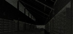

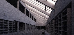

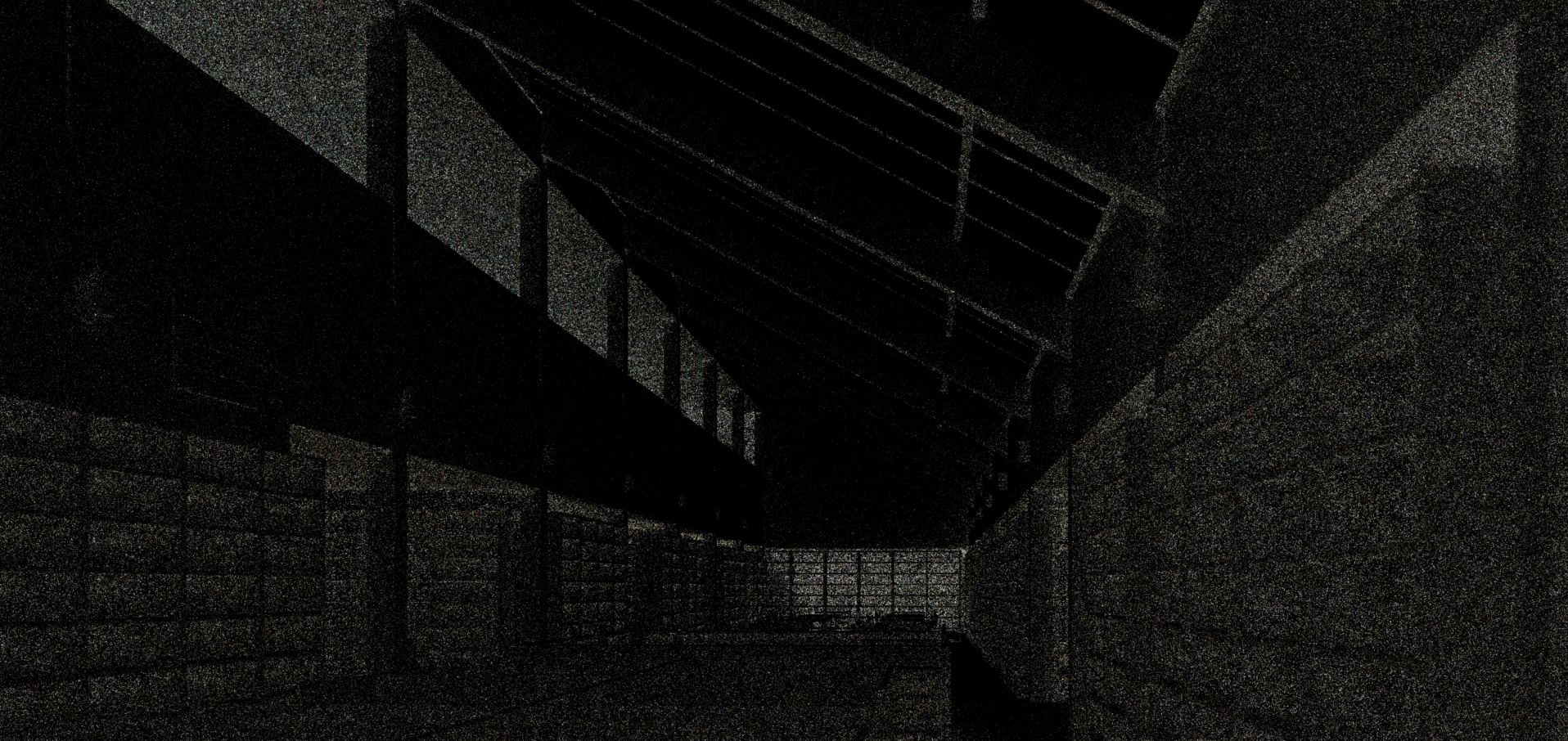

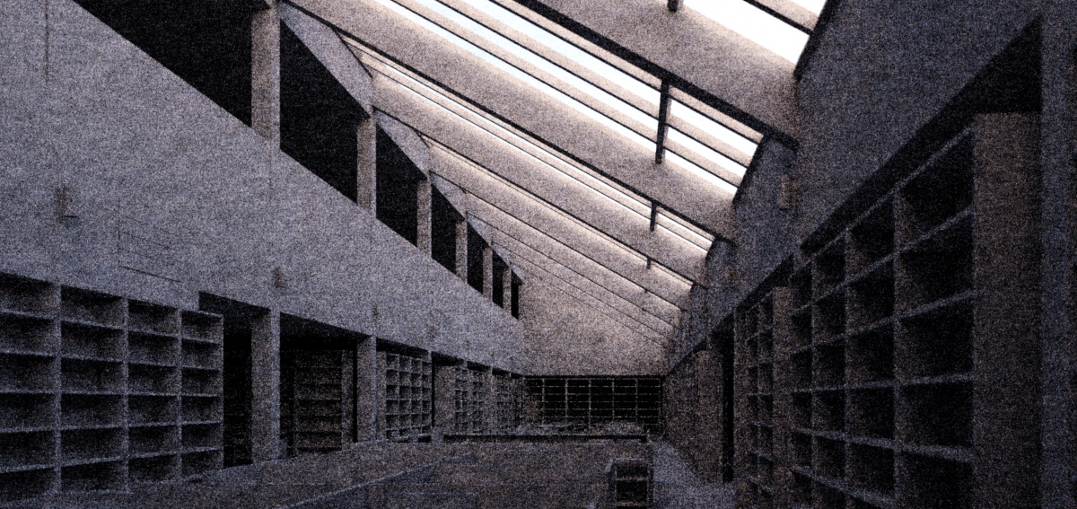

..any of you guys noticed that in the current version ExitPortals don't work anymore?
..or it's just for me?
EDIT
Attached two sample images of my ongoing project

..anyone is getting the same issue using exit portals with the current version of Indigo? ..maybe it's a SkIndigo issue then..
Post by OnoSendai » Fri Apr 12, 2013 4:40 am
Pibuz wrote:Thanks again Zom-B! I'll try that out!
Exit portals seem to work for me.
Post by Pibuz » Fri Apr 12, 2013 4:49 am
...well..here too in a much simpler scene..
..so what the heck is going on in the library?!?!? :-?
..gonna check that later and tell you guys..
sorry, for now..
Post by Pibuz » Sun Apr 14, 2013 5:43 am
Ok found the problem.
It's some sort of issue showing up when using exit portals, which not only exclude parts of the geometry from the calculation but also have some kind of effect on how Indigo calibrates emission powers.
In the same scene conditions, when not using exit portals I had to put the emission power of the EXR to absurd values; when I introduced the exit portals in the latest tests those values were so high that burned the image to the point it seemed like..inverted. It's been enough to push down the EXR emitting value and scale and it's now rendering correctly.
So, not a bug but sort of a..malfunction maybe?
Thanks for having checked Ono, btw!
