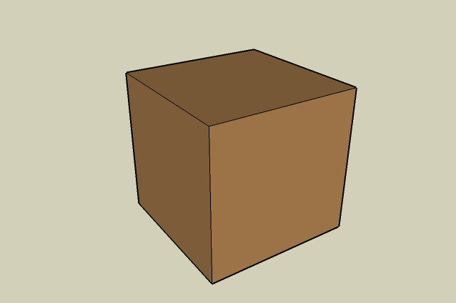

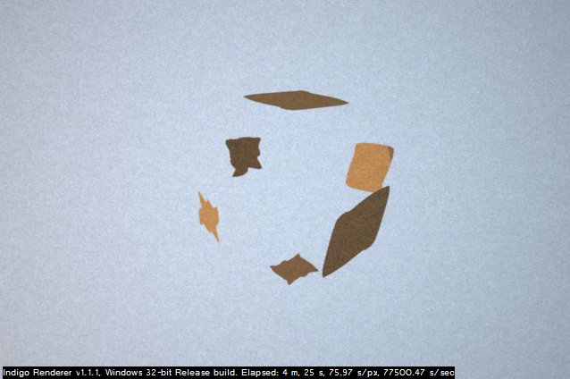

Post by cpfresh » Thu May 29, 2008 6:38 pm
same here actually. i cant even get a simple cube to subdivide without either 'blowing-up' (like a balloon) so large as it blocks the entire scene. either that or the cube faces actually blow apart (refer to attached images)
is there a way to find out exactly what the subdivision strings actually mean to the geometry of the model? itd help alot when trying to figure out what is going on.
exploded cube (using a curvature threshold of -1 - the rest stays the same)
original skp cube
blown-up cube (using subdivide code snippit from this post)
Post by OnoSendai » Thu May 29, 2008 6:57 pm
Hi guys,
as you've found out, the subdivision code (with smoothing) is pretty fussy when it comes to mesh topology.
For starters, the mesh needs to be a 2-manifold, and cannot currently have any boundaries. Subdivision smoothing on surfaces with boundaries will be supported in the next release.
Any pair of triangles are only considered adjacent by Indigo if they share an edge. An edge is shared if and only if the two triangles both index the two vertices making up the edge.
So what's probably tripping up a lot of people is that vertices shared between triangles must be written out to the scene file only once, and the triangles must index that vertex.

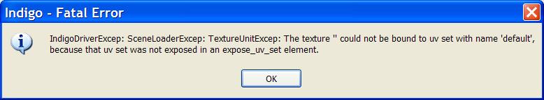

Post by mrmoose » Thu May 29, 2008 9:49 pm
I just try to use the Official Indigo Material Preview Scene and modified the previewmats.igs file to change the material. But if I add texture map an error popup... :(
How can i correct it?
Thanks :D
drBouvierLeduc
Posts: 412
Location: france
Post by drBouvierLeduc » Thu May 29, 2008 9:54 pm
I had the same error. If I remember well, you must change the uv name of your material from "default" to "uv".

Post by mrmoose » Thu May 29, 2008 10:17 pm
drBouvierLeduc wrote:I had the same error. If I remember well, you must change the uv name of your material from "default" to "uv".
Thanks dr, it works!!! :wink:
