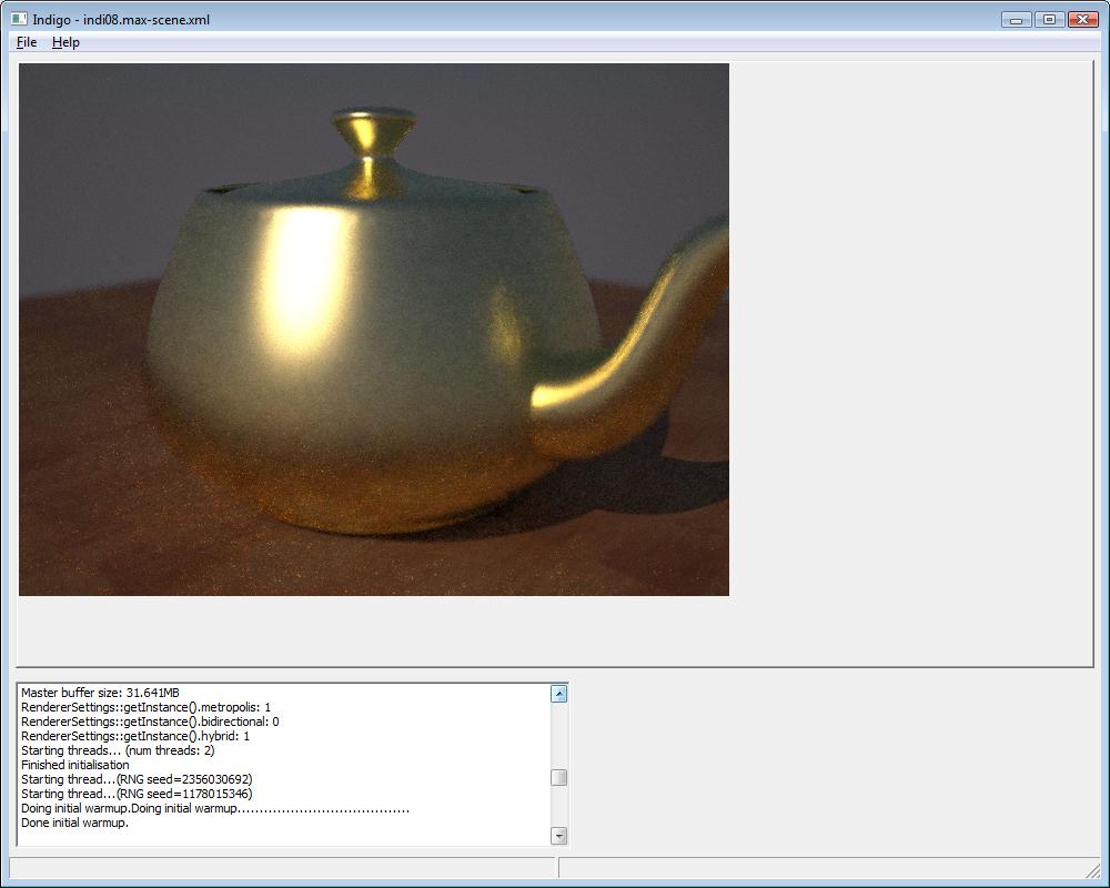

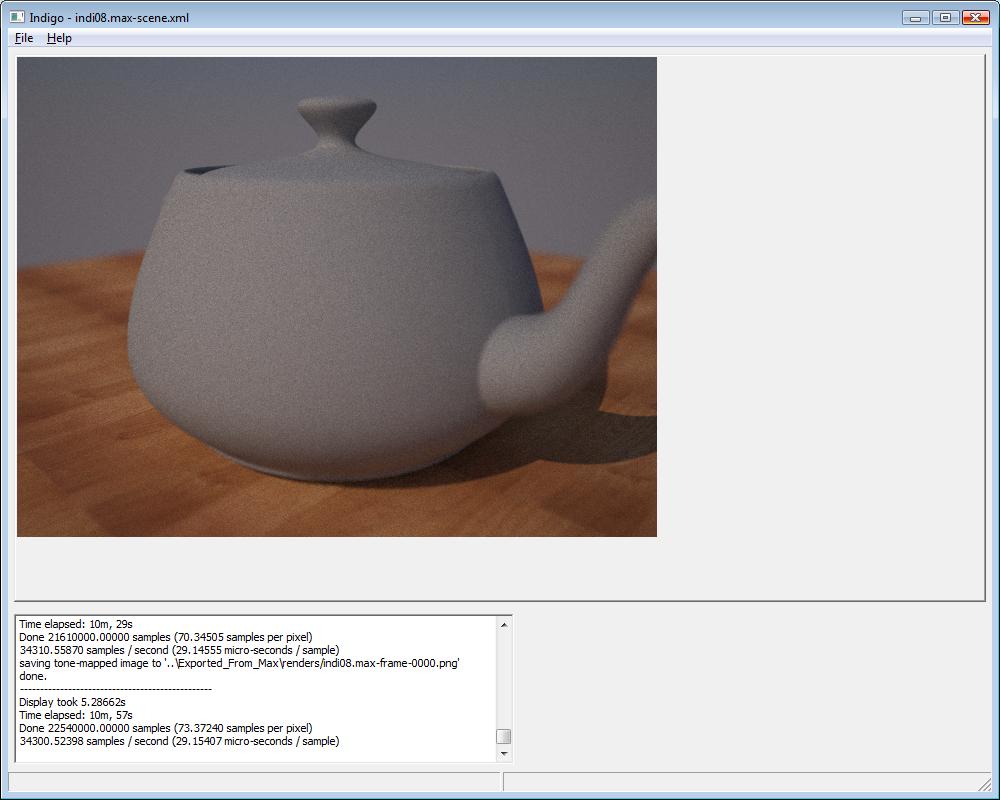

If we use HYBID and BIDIRECTIONAL after few minutes or samples
the image go to dark mode...
If you turn off BIDIRECTIONAL all works fine...
then the question is...
when we must use Hybird mode? Only on direct light: SUN LIGH ONLY
see these images
BIDIRECTIONAL ON
BIDIRECTIONAL OFF

hey tizxx......i dont think bidir or hybrid afects the problem....i just render an scene with bidir on and hybrid off....renders ok for 15 minutes....then i close the render and i restart them an oupsss all is black.....with some wheti dot here and there....i think some randomnes with this problem....Onoooooooooooooooo

Now If we use Diffuse materials insteat PHONG Materials
there is no problem.
BIDIRECTIONAL + HYBRID MODE with diffuse materials
is more quick than no bidirectional and no hybrid.
Hybrid mode is physically correct solution?
Bidirectional mode is physically correct solution?
If we turn toghether off we have a physical correct solution...
All Materials are DIFFUSE - BIDIR ON - HYBRID ON

i dont realy know....ana he says there is a bug with bump map tha couses the black images but here u have any bump?i think no....so...im confused...i hope Ono fix this strange situation! :roll:

this is without bump mup
All materials are of PHONG type
works fine...
