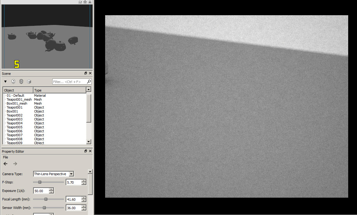

Aperture diffraction: Normal aperture diffraction does not work in BiDir modes. Post process works in all render modes.
Camera changes position/direction when settings are changed (eg. Resolution, render mode, SS, sometimes F-Stop). The OGL window will still have the original camera frame and zooming in/out slightly seems to reset the rendered camera to the original position (shown in OGL window).
Re: Indigo Renderer 3.4.2
Post by fused » Tue Jul 24, 2012 9:18 pm
ENSLAVER wrote:Camera changes position/direction when settings are changed (eg. Resolution, render mode, SS, sometimes F-Stop). The OGL window will still have the original camera frame and zooming in/out slightly seems to reset the rendered camera to the original position (shown in OGL window).
Hey,
can you upload an Indigo scene that shows this problem?
ENSLAVER
Posts: 399
Post by ENSLAVER » Wed Jul 25, 2012 2:11 am
Hey,
Sure. To be more descriptive it seems to happen when I change from MLT to PT or PT to MLT modes. The f-stop issue is more intermittent. I will play around more and try to find a procedure to reproduce it.
EDIT: The f-stop issue seems to only happen when you first load/render the scene. Unlike the above bug the OGL window actually changes as well as the rendered window. Also this time a small zoom in/out does not reset the camera to it's original position.

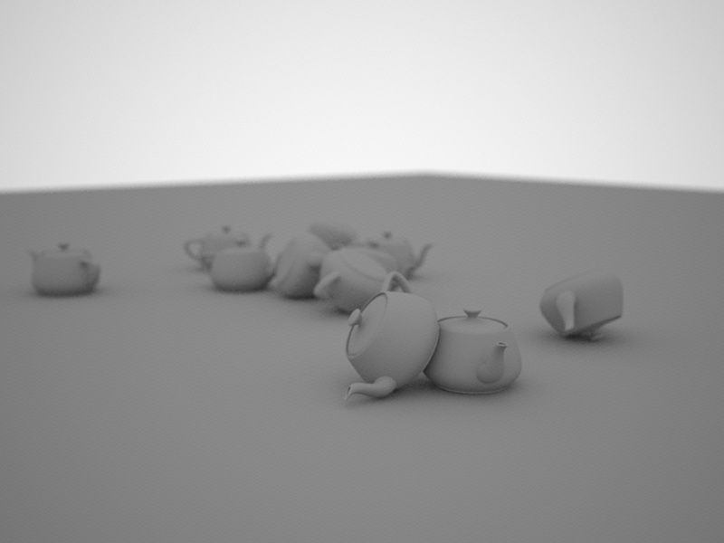

EDIT2: I noticed I am running 3.4.4 rather than 3.4.2 ..OOPS
The PT.jpg is the original render, the afterchangetoMLT.jpg is the render after changing render modes.
