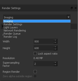

No clues in the render log?
Re: Indigo Renderer 4.0.47 Beta Release
Where do I find the render log?Oscar J wrote:No clues in the render log?
- pixie
- Posts: 2346
- 3D Software: Cinema 4D
On the drop down menuwalnist wrote:Where do I find the render log?Oscar J wrote:No clues in the render log?
