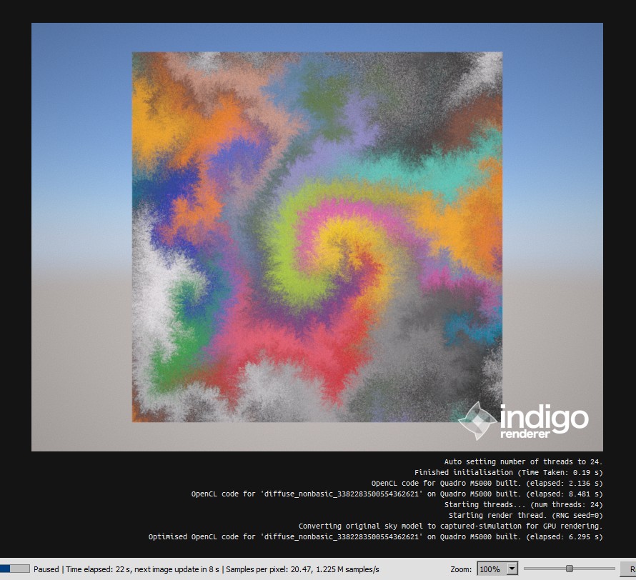

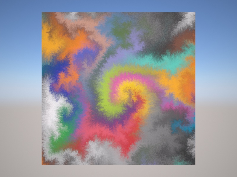

Re: Indigo Renderer 4.0.46 Beta Release
Intreresting, renders fine for me:Zalevskiy wrote:at this scene with GPU freezing process 0.34 spp (without errors)
after re-click on the play
clCreateContextFromType failed: CL_DEVICE_NOT_AVAILABLE
Auto setting number of threads to 4.
Finished initialisation (Time Taken: 0.29 s)
OpenCL code for Quadro K2200 built. (elapsed: 1.493 s)
OpenCL code for 'diffuse_nonbasic_3382283500554362621' on Quadro K2200 built. (elapsed: 12.47 s)
Starting threads... (num threads: 4)
Starting render thread. (RNG seed=0)
Converting original sky model to captured-simulation for GPU rendering.
Optimised OpenCL code for 'diffuse_nonbasic_3382283500554362621' on Quadro K2200 built. (elapsed: 9.618 s)Re: Indigo Renderer 4.0.46 Beta Release
