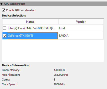

Voytech wrote:Image
Crashes on "Building OpenCL kernels."
Have you updated your drivers to the latest?

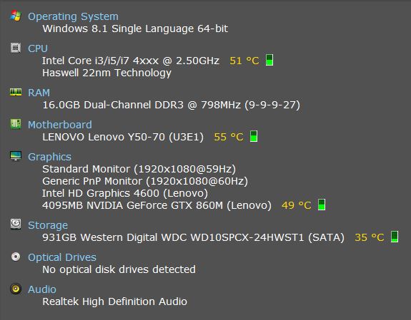

Strange, when loading the "Arthur" scene, when I select GPU rendering (obviously selecting the GPU as well) and hit render it starts off quite soon, but wen doing the same and selecting >tools>options>information overlay it takes quite a while to build the scene before starting rendering, in fact so long that I quit the process after 10 minutes and reload to render without selecting information overlay. Strange.
Anyhow, here are my figures:
Speccy didn't specify, but i7-4710HQ CPU
Indigo 4.0.30, win 8.1 64-bit, 2m28s, 346.81s/px, 2.071Ms/sec
Indigo 4.0.30, win 8.1 64-bit, 3m15s, 192.78s/px, 0.884Ms/sec
