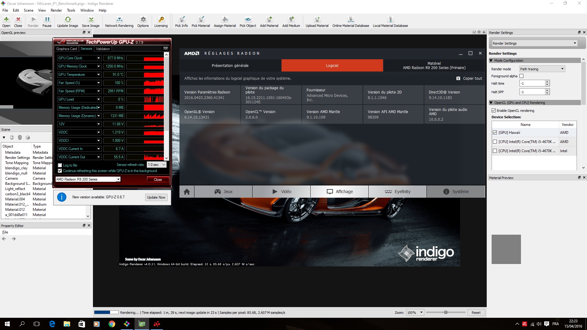

Post by Esenistras » Sat Apr 16, 2016 7:47 am
R9 290
Oscar: only 2,2M s/s
Something is wrong :S

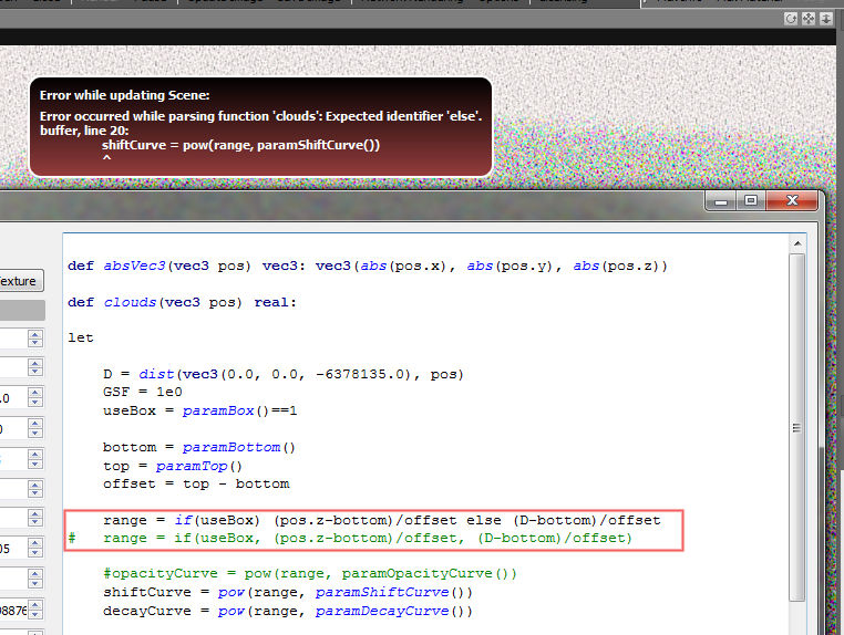

Post by CTZn » Sat Apr 16, 2016 9:01 am
I spent the evening undoing that :) I once sent you a zipped sequence, the cloud shader should feature the issue after adaptations to 4.0. I can send you the current shader by PM.
In the attached image you can see the error after I swapped the commenting status between the two lines boxed. I must then revert all if-else statement to the old scripture and then the shader works.
Post by OnoSendai » Sat Apr 16, 2016 9:04 am
CTZn wrote:I spent the evening undoing that :) I once sent you a zipped sequence, the cloud shader should feature the issue after adaptations to 4.0. I can send you the current shader by PM.
In this case, try adding a 'then' token:
For example:
if a then b else c
Post by CTZn » Sat Apr 16, 2016 9:12 am
For example:
if a then b else c
Ah thank you, I didn't know about the 'then' statement ! That worked indeed.
Post by OnoSendai » Sat Apr 16, 2016 9:28 am
CTZn wrote: Ah thank you, I didn't know about the 'then' statement ! That worked indeed.
It's optional, and only required in some places where the grammar is ambiguous.
Post by Oscar J » Sat Apr 16, 2016 9:52 am
Esenistras wrote:R9 290
Yes, that's definitely lower than expected. Are you running the latest drivers? Are you using your GPU for your display - if so, are there any other processes running?

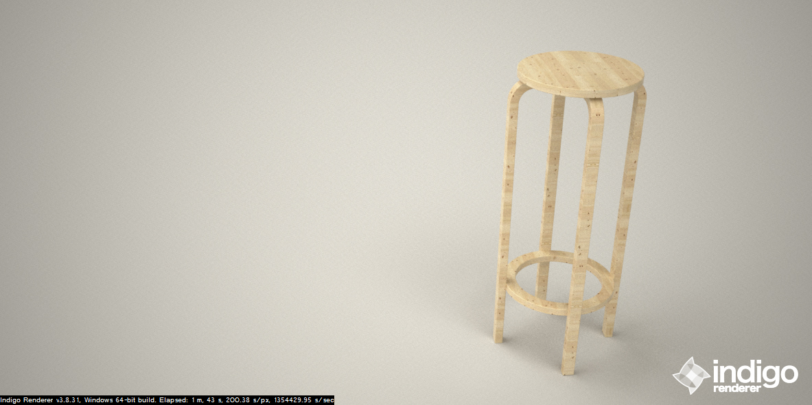

Post by Tramis » Sat Apr 16, 2016 9:54 am
I made few tests with Halt SSP. I set the limit 200, but as you can see in the picture it passed the limit. Dunno why.

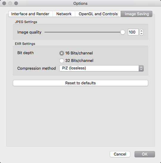

Btw in the future it would very advantageous to be able to compress images (Low, Medium, High, like photoshop and other image editing apps has).
Post by Oscar J » Sat Apr 16, 2016 9:57 am
Tramis: Odd about the halt spp thing. Regarding image compression: Indigo has that under Image Saving in Preferences:
Post by OnoSendai » Sat Apr 16, 2016 9:59 am
Hi Tramis,
You can set the Jpeg quality in the options dilaog.

Post by Zom-B » Sat Apr 16, 2016 10:18 am
Sounds to me like you are maybe using old drivers?! What version is installed?
Double-check that you only use the GPU for rendering and not the together with the CPU!
Also if you can, please monitor GPU usage during rendering... you also need to wait at least 3-4 min until s/sec stabilized!
Esenistras
Posts: 6
Joined: Sat Apr 16, 2016 7:22 am
Post by Esenistras » Sat Apr 16, 2016 11:31 am
OK my computer reached 100% RAM usage (16GB) and Vram usage (5338MB VRAM pikes)...
I'm using latest driver (non-WHQL 16.4.1).
I also tried with all programs closed (chrome, anti-virus ect).
Post by Oscar J » Sat Apr 16, 2016 11:45 am
Did you try waiting a little longer?
