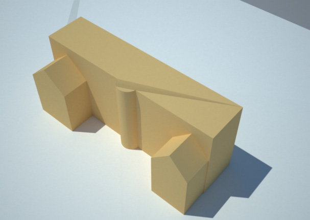

[quote="Rafaello"]Hi Ono, it's getting better and better, but I want to know about some shadows that appear in the render as I posted here http://www.indigorenderer.com/forum/vie ... =27&t=5796, they appear in 2.06 aswell[/quote]
Hi, I´m also getting strange "shadows".
It´s a very simple and clean scene - and they don´t appear, if rendered with indigo 1.1.16
Re: Re:
Post by pixie » Wed May 20, 2009 2:24 am
[quote="thiloo"][quote="Rafaello"]Hi Ono, it's getting better and better, but I want to know about some shadows that appear in the render as I posted here http://www.indigorenderer.com/forum/vie ... =27&t=5796, they appear in 2.06 aswell[/quote]
It´s a very simple and clean scene - and they don´t appear, if rendered with indigo 1.1.16[/quote]
It has scale issues...

I don't get it, all my scenes were rendered ok with previous versions of Indigo, no scale or geometry issues before, I'm trying the new versions of Indigo with my old scenes and the new scenes are rendered with 1.1.18. I had to melt triangles in one mesh and subdivide other to correct it to work with 2.06, so I don't think the problem is in the scenes.

well scale issues...
you are right, that I get rid of the shadows, if I scale down the scene. But then my drawing units are not 1m anymore, but 10m (or even 100m). And it´ll get messy, when adding lights.
I also could divide the surface in smaller pieces.
But both methods are not really practical.
Re: Indigo Renderer 2.0.6
Post by CTZn » Thu May 21, 2009 8:57 am
Thiloo, since I'm curious, and since that should be reasonably lightweight, could you please attach the (unfixed) igs (zipped or with an accepted extension) ?
Just out of curiosity really, I didn't run into that issue yet that's why I'm asking, thank you in advance.
Post by OnoSendai » Thu May 21, 2009 10:51 am
Hi Thiloo,
Can you please post the scene here, or email it to me?
(nick at indigorenderer.com)
Post by thiloo » Mon May 25, 2009 11:45 pm
sorry for not replying earlier,
was on a short-holiday over the extended weekend.
attached the file.
thanks for looking into it.

Rafaello wrote:I don't get it, all my scenes were rendered ok with previous versions of Indigo, no scale or geometry issues before, I'm trying the new versions of Indigo with my old scenes and the new scenes are rendered with 1.1.18. I had to melt triangles in one mesh and subdivide other to correct it to work with 2.06, so I don't think the problem is in the scenes.
Rafaello wrote:Thank you both, I melt the triangles in a mesh and everything Ok, but in another scene I have to triangulate a mesh to make it work, so I'm confuse and I think the problem is in Indigo, because with the 2.02, 2.03 and 2.04 versions I had no problem with the same scene.
Got that problems on a scene of mine recently, too.
Definitely not a problem of our geometry as 1.1.18 works just fine with it!
