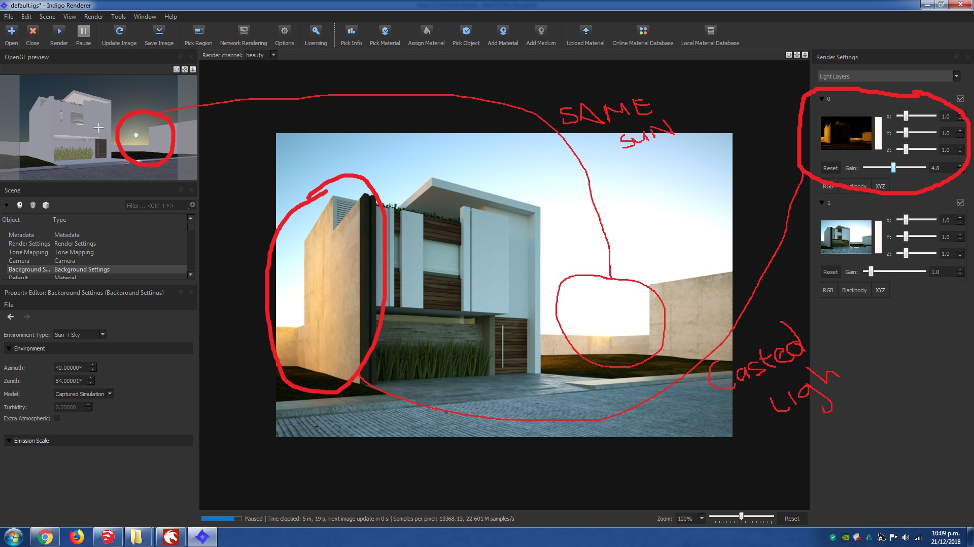

I've been doing some test with this new version and i found that the sun displayed in the " OpenCl preview screen" does not match with the light casted from the sun light layer, i mean ,it seems that i have 2 suns ( or an extra unknown light source) in my scene :

Re: Indigo Renderer 4.2.23 Stable Release Candidate
Post by Zom-B » Sun Dec 23, 2018 12:17 am
Lal-O wrote: ↑
Sat Dec 22, 2018 4:27 pm
Don't trust the thumbnail, disable your sky layer and see if there is a sunin your viewport ;)
Regarding the bright area on the left: since you pushed the sun LL power by x4.8 it is a good chance that this is simply the reflection of sunlight from a wall you have far left outside the camera. Disable the wall and see :)
Lal-O
Posts: 348
Location: México
Post by Lal-O » Sun Dec 23, 2018 5:14 am
Zom-B wrote: ↑
Lal-O wrote: ↑
Hi Zom-B! Thx for the reply.
I've made some new quick test without any changes in the model and now all is working like charm,the unknown light source seems to be gone, i just can not explain it :)
