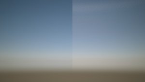

Never noticed it before with this beta : sky is half white when looking at azimuth 0° with :
- value of sun azimuth for -1° to -179° or 180 to 360°
- Bdir or Bdir MLT
- captured simulation
Tested with camera, aperture diffraction not enabled
Indigo RT / Cindigo - Mac OS 10.9.3
Also in an empty test scene (join)
Thanks for your help
Patrice

Post by OnoSendai » Sat May 24, 2014 1:02 am
Patrice wrote:Never noticed it before with this beta : sky is half white when looking at azimuth 0° with :
- Bdir or Bdir MLT
Patrice
Thanks for the report Patrice.
This issue is fixed for 3.8.3.

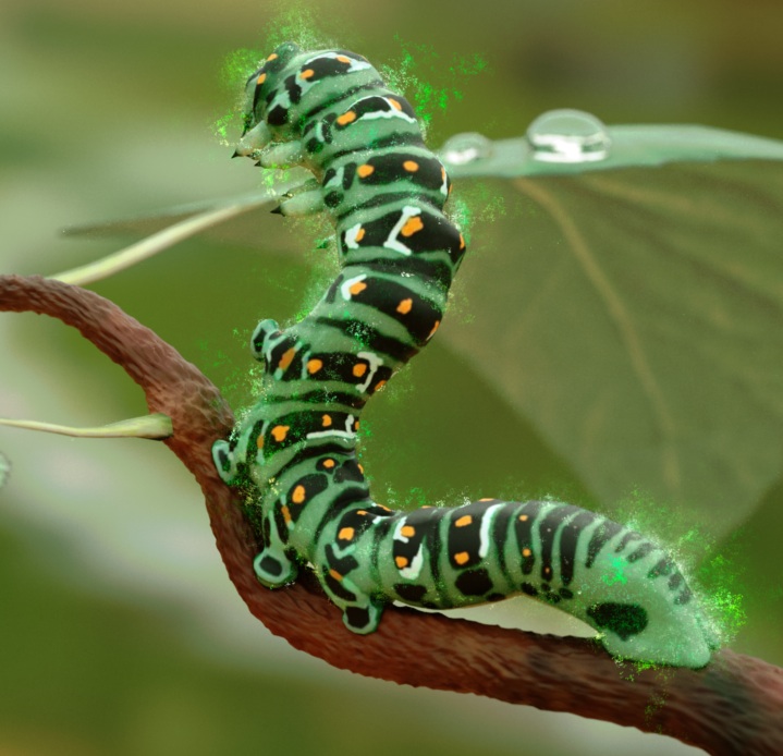

Rendering with MLT gives me weird results in this scene.

Oscar J wrote:Rendering with MLT gives me weird results in this scene.
The caterpillar scene gives different kinds of strange artifacts each few version, no idea what black magic is going on here :/

Post by yonosoy » Mon Jun 16, 2014 1:03 pm
Hi. The glitch is due to an unbeliveable circumstance for max. extinction coefficient, meanwhile the more abstract approximation of step-size was able to "resolve".
For the leaf, that is in fact a surface is not possible use this high value of SSS, works if the absorption gain is reached to near 90 (but for this is intended the double-sided thin material, that don´t use max. extinction.
For carterpillar the problem is an exhauxting value of the SSS uniform spectrum. This spectrum is a physic value (instead of RGB, than is more an abstraction) and the meaning is 1/value meters of "penetrability", after the light extinct; this means that in a distance of 1/4771,0644 meters inside the caterpillar, the light "fall-off" totally (a massive extinction).
So, a value near 90 for the gain of the leaf absorption (better another kind of values/materials) and a RGB spectrum off gain 16 in cartepillar SSS definition. As result for two minutes:
Re: Indigo Renderer 3.8.2 Beta Release
Post by Zom-B » Mon Jun 16, 2014 8:16 pm
yonosoy wrote:Hi. The glitch is due to an unbelievable circumstance for max. extinction coefficient, meanwhile the more abstract approximation of step-size was able to "resolve".
Ha ha, finally fixed after so many years ^^
This should be fixed for next release (3.8.6).

yonosoy wrote:Hi. The glitch is due to an unbeliveable circumstance for max. extinction coefficient, meanwhile the more abstract approximation of step-size was able to "resolve".
Actually Indigo can cope just fine with a scattering coefficient of 4700 or more. I used 50000 for my head render.
