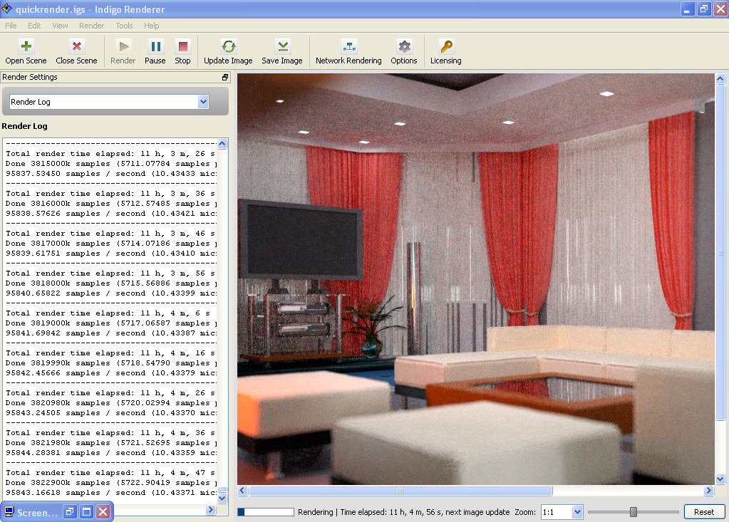

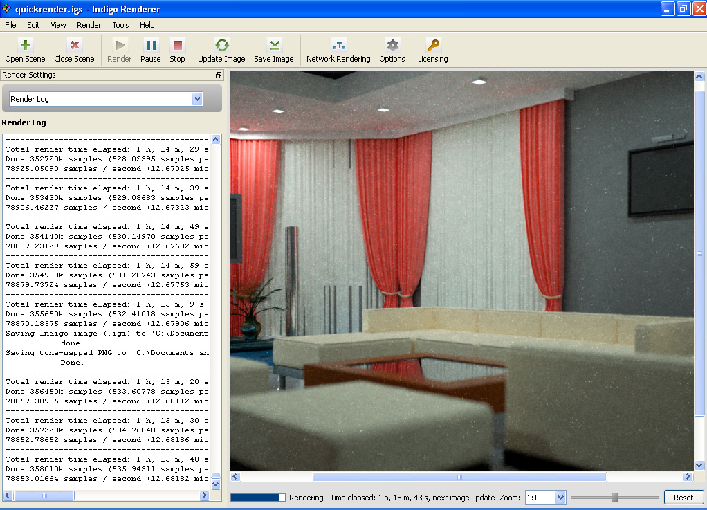

Excuse but I do not have time to be engaged in it. I have simply compared two identical scenes and have specified you concrete result. And all manipulations of a scene in the Photoshop the identical. The scene difficult enough that that has flown down all matte. Even in 11 hours there is a noise, I think it long. I wait when render it will be possible to keep normally in a file and then to continue рендер as it is made in Makswelle. In the scenes I use only MLT with BiDir, as it the most realistic but it purely my opinion.

Yes, I have to admit that after 5700 samples your scene is still quite noisy :/Prof4D wrote:The scene difficult enough that that has flown down all matte. Even in 11 hours there is a noise, I think it long.
If I should guess why this is so, I would point my finger @ light Strenght of a/some emitter in your scene!
Indigo weights importance of light Emitters for casting rays by the streanght of light they emit!

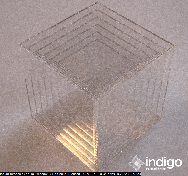

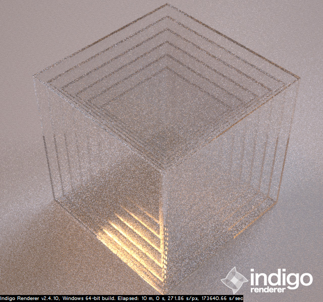

Ok, here it is: 6 cubes of glass inside each other on a plane lit by a EnvMap.Zom-B wrote:I'll try to create a simple but (light-wise) complex scene to demonstrate and benchmark!
Pure MLT has here 61% more samples and image looks cleaner (PNG filesze 724kb vs 678kb)
**EDIT**
I added also some PT & PT+BiDir test with same tendency regarding speed & noise for this scene

I have found in what a problem, which I have applied Material Ljuminositi not indigo and is pure
Material of Cinema4d, after material replacement all has settled into shape. But then it is strange whose then this error. And concerning tests I with pleasure would receive the working indigo version in exchange for works for Indigo advancement. I am registered on Evermotion a site and too participated in competitions but a problem in the licence. I cannot expose anything from the works as the size of the image does not allow to make it.

Yes, hollow cubes with 2.5mm thick glass walls inside each other... I thought this could be some somehow "complex" ^^
Just tested today the difference between RGB & uniform for glass in this scene today, and my result is that uniform is faster here for 1,9%.
