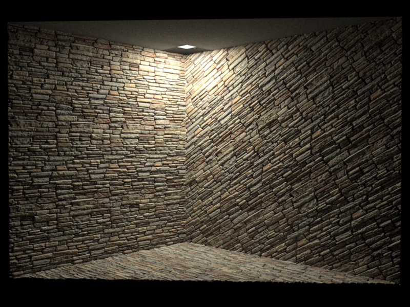

subdivision copes better with boundaries now.
Thanks for this release, ono! This scene would not work in the previous version but it does now! The IGM packing stuff sounds great too!

A couple issues just found:
1) Indigo is not packing displacement maps (only tested using GUI version)
2) It would be nice if the default filename for packed scenes and packed materials would be the same as the original filename instead of 'packed.pigm' or 'packed.pigs'
Post by OnoSendai » Wed Jun 04, 2008 7:09 pm
Yup, will fix both points whaat.
nice displacement test!

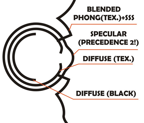

Nice displacement Whaat. Any link for the map?
I'd like to know if the sss problem is planed to
be fixed in future releases. (I'm thinking of rendering
human head with phong eyes inserted without postproduction, skulls
and stuff).
Thx for any ansver!

Post by StompinTom » Thu Jun 05, 2008 2:36 am
you should either fire that mason or make sure your foundation isnt sinking. somebody forgot the level...
Whaat
Posts: 1827
Location: Canada
Post by Whaat » Thu Jun 05, 2008 4:14 am
haha...
The odd uv mapping was to show that the subdivision and displacement mapping works now using duplicate vertices with different UV coordinates (i.e. discontinous mesh). With version 1.1.1, the geometry would have blown up.

aleksandera
Posts: 380
Location: Slovenia
Post by aleksandera » Thu Jun 05, 2008 12:18 pm
Ups, I found a solution for my sss problem. won't
bother any more.
Thx for the relese hehe!
Take care and regards,
Aleksander

aleksandera
Posts: 380
Location: Slovenia
Post by aleksandera » Thu Jun 05, 2008 8:39 pm
Shure!
Here it is:
Post by Kram1032 » Thu Jun 05, 2008 8:40 pm
That's not what he asked for. Nice though ;)
(He asked for what you actually did wrong)
aleksandera
Posts: 380
Location: Slovenia
Post by aleksandera » Fri Jun 06, 2008 2:18 am
Here is how I did it.
"Thx" to all who knew, but didn't tell.
