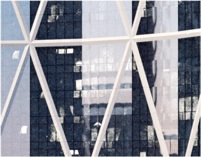

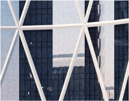

Hey,
There seems to be a bug with Architectural Glass and Blend materials.
The first image is using a simple Specular material with Architectural enabled.
The second image is using the same material but also blended a tiny bit with a Phong material (0.1:0.9 ratio).
The third image is disabling Architectural on the Specular material. Here the sunlight shows up, albeit very slowly...
As you can see, the sunlight has no problem appearing on the inside of the glass in the first image, though it is absent from the second. The sunlight starts to resolve on the third image with architectural glass disabled. I have tried different render modes and also leaving the rendering on for longer to see if sunlight appears, but with no success.
