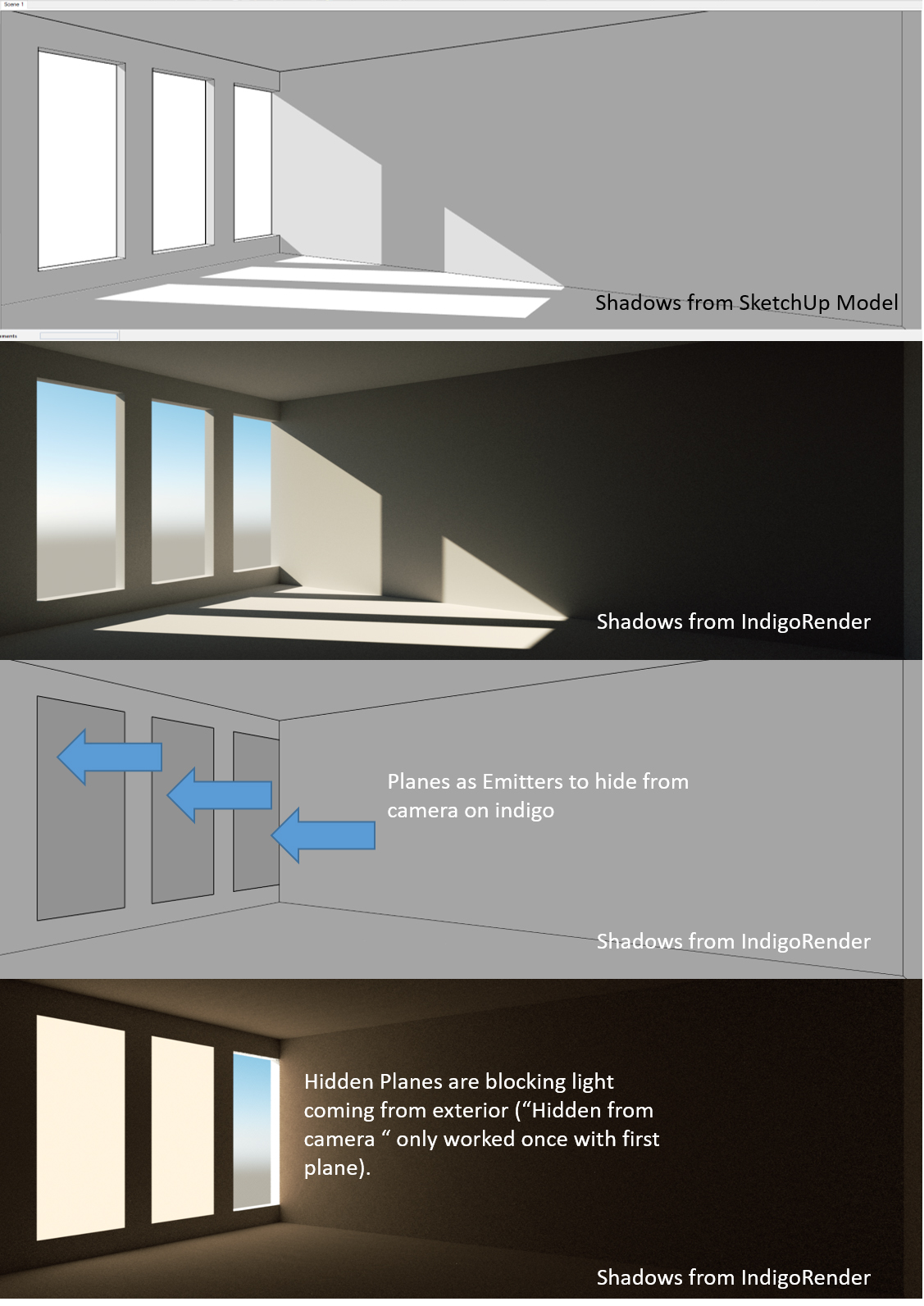

I've been doing some test and i've found some issues with "Hide from camera" feature, it seems that the hidden objects blocks the light. This happens with CPU and GPU. I attach an example:

Lal-O wrote:
Sat Mar 20, 2021 2:00 pm
Thank you for this new Beta release.
I don't know about the material, but unless it is set null it will always block light

pixie wrote:
Sat Mar 20, 2021 8:37 pm
Indigo's "invisible object" always block lights;) ohh, too many bad rendered images... but if you will increase max ray light depth, your lighting rays will pass thru the "invisible" object without "shadow". p.s. it's much better to buy RT because it has no "invisible" objects ;)
Re: Indigo Renderer 4.6.0 Beta Release
Post by Oscar J » Sun Mar 21, 2021 9:03 am
As has previously mentioned, invisible objects block light by design. They're only hidden from the camera, not to light sources etc. They're also visible through glass and in mirrors.
Lal-O
Posts: 348
Location: México
Post by Lal-O » Mon Mar 22, 2021 7:15 am
Ok, thx for the explanation :) .
So, what do i need to do to get invisible emitters? ( objects wich cast light but light source is not visible). :)
pavoda
Posts: 188
Post by pavoda » Mon Mar 22, 2021 7:21 am
Hi,set material as "Null material".
Lal-O
Posts: 348
Location: México
Post by Lal-O » Mon Mar 22, 2021 7:55 am
Thank you very much Pavoda 👍🏻
