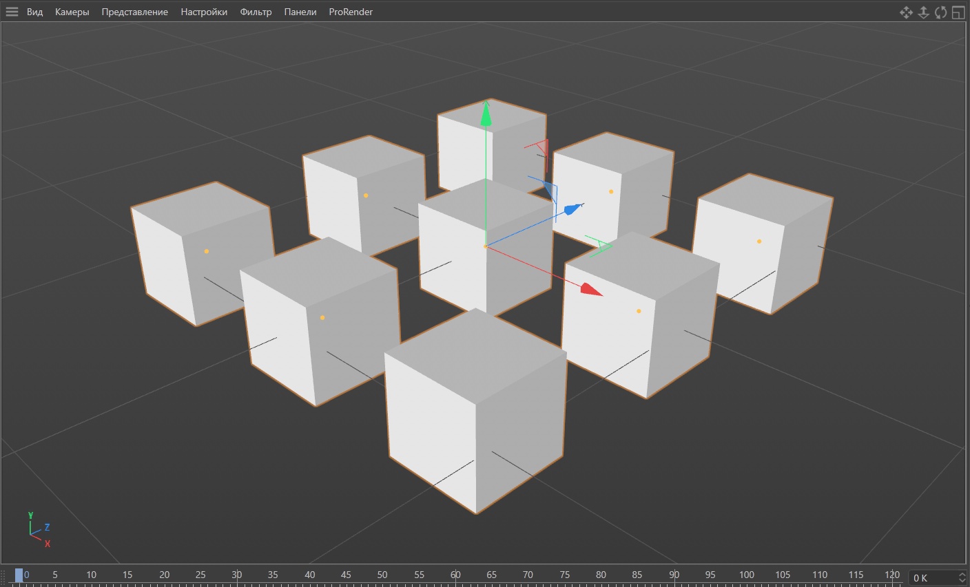

you will get much more fun if you'll just try to render c4d's cloner instances, deformers, matrix objects or bones-animated objects with keyshot (9.3.14)...
p.s. keyshot is an alpha (no even beta) state app now that guys sell like something real working.
c4d:
ksht:
very nice app!
ahh... and c4d scene has no plane under that cubes for that pretty keyshot's shadows on it;) very fun.

The thing is, this kind of experiment has zero real world relevance. What company is going to ask you to render a couple of cubes? For people who do this for a living, having rock solid stability in areas that relate to the work is crucial.
keyshot is an app for rendering single simple fxb mesh placed under the hdri map. that's all
