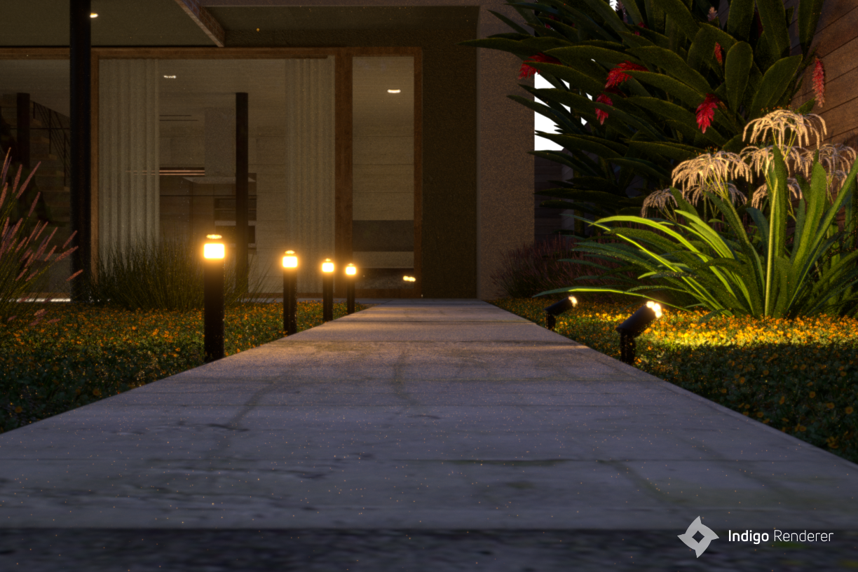

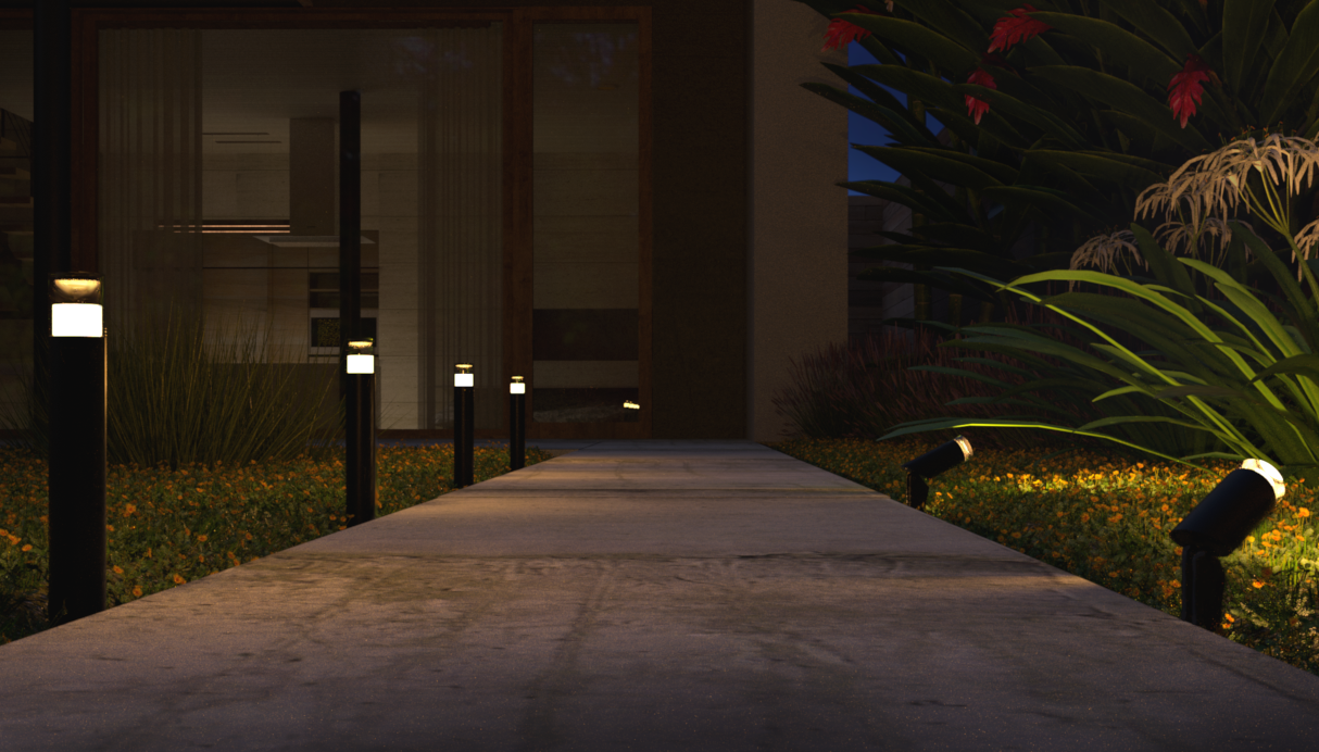

Hi, i was working on this scene from a sketchup model,
so the problem is that i wasn't able to render using openCL.
indigo version 4.2.23
if i render using everything ok no problem.
went i choose GPU to render the light layers (lampara jardin,) didnt work only the hdri layer and the other lamps but not the one in the garden.
i set the tone mapping to camera or Reinhard but i didn't make any difference.
i save the scene as a pigs file in order to render in other computer but it has the same result the light layer lampara jardin didn't work on GPU render just CPU.
For ligthing i use
hdri map layer 4
ies lamp layer 2,3
presset light material layer 1
aperture deffraction on
aperture deffraction off
aperture deffraction ofF
hdri layer 0.0001
GPU RENDER OK IN THIS ONE
hdri layer 1

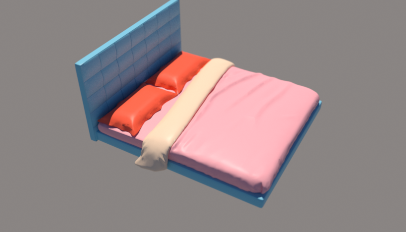

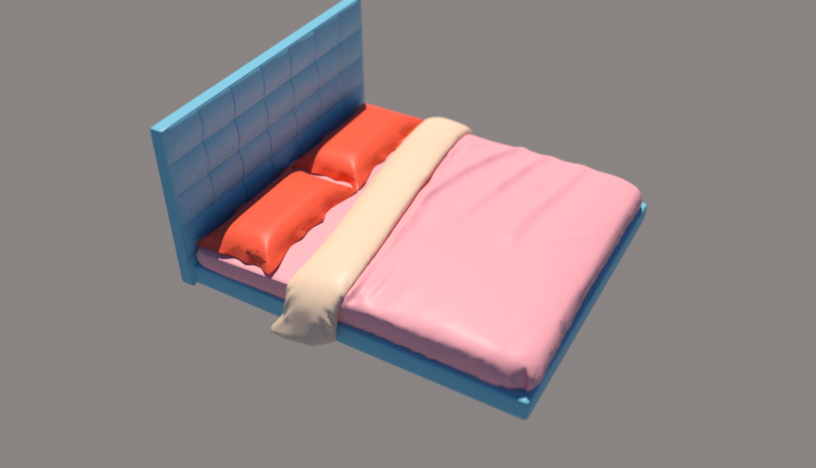

Post by snorky » Sun May 05, 2019 4:26 am
a simple render....
I tried to change from sun + sky to environment map and this appears
Indigo Renderer 4.2.23
Skindigo 4.2.21.3
What happens?
thanks

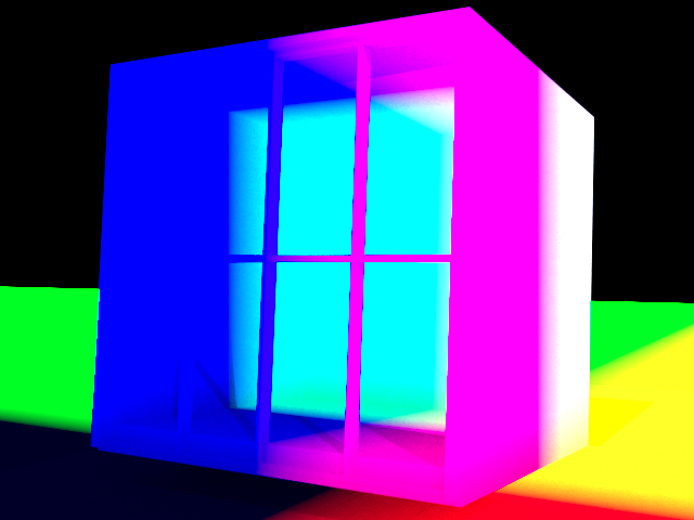

Hello
I think I have identified a bug in the "position" render channel.
The values of this channel is not the same if the "depth" render channel is toggled or not.
If the "depth" chanel" is not toggled, some shadows are appearing in the "position" channel.
I attached the outputs of the position channel with and without depth with ~ 1000spp.
I also attached the igs + meshes.
Thanks.
scene.zip
(315.21 KiB) Downloaded 880 times

Hi. I've experienced this before and this is what i got from Zom-B :
....."this is afaik a known issue if you change scene parameters early after GPU render started and the image is still rendered in subpixel resolution.
Double check by having your render cook for a few minutes before changing the parameters, it shouldn't happen then".

SimonM wrote:
Thu May 16, 2019 12:31 am
Hello
Thanks.
Nice find, thank you, fixed for next build.
It's a problem with MLT and render channels btw, change to non-mlt to work around.

snorky wrote:
Fri May 17, 2019 10:42 pm
Lal-O wrote:
Fri May 17, 2019 12:41 pm
Thanks Lal-O
:D
I think this is fixed already for the next build.
