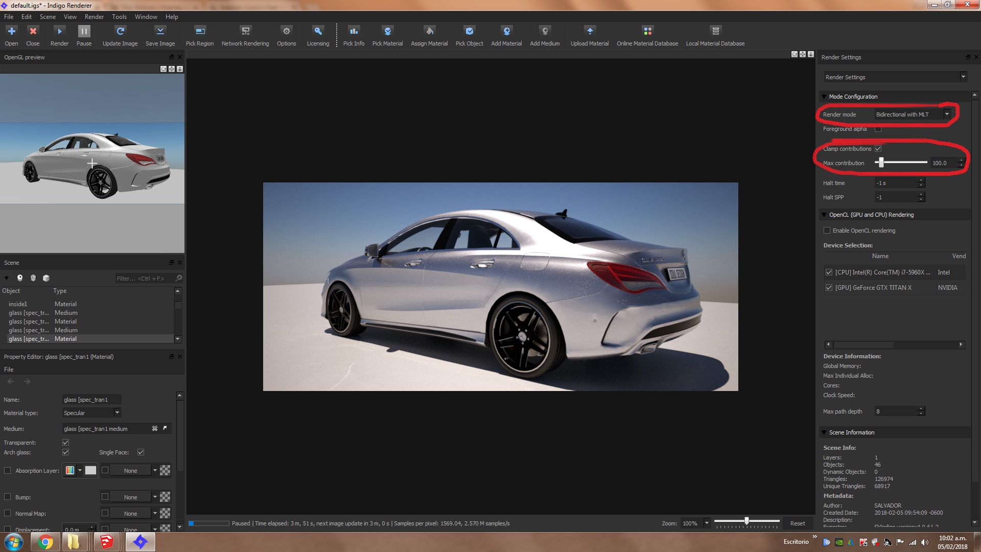

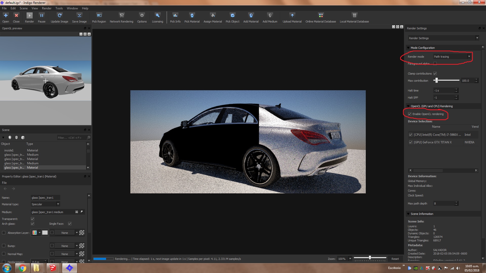

Hi.
2 things :
1) I've found something weird while working with a Car Paint Shader ( downloaded from the Indigo Material Repository :https://www.indigorenderer.com/materials/materials/1323 ) and Open Cl mode.
In Open Cl mode, some random black artifacts appears all over the scene, but they are not still, they show up in the rendering screen .All of the other render modes works perfect.
2) How to get rid of white little dots in some rendering areas ? I tought that by enabling "Clamp Contributions " option they will be deleted U.U
Re: Indigo Renderer 4.0.65
Post by Oscar J » Tue Feb 06, 2018 5:41 am
Hi Lal-O.
That car paint is kinda complicated with interference enabled, which apparently doesn't work well on GPU. Are you sure you need interference? Otherwise, there's a pretty much identical material without interference here: https://www.indigorenderer.com/materials/materials/1322
The white dots are metallic flakes in the car paint. If you don't want metallic flakes, you might want to use another material.

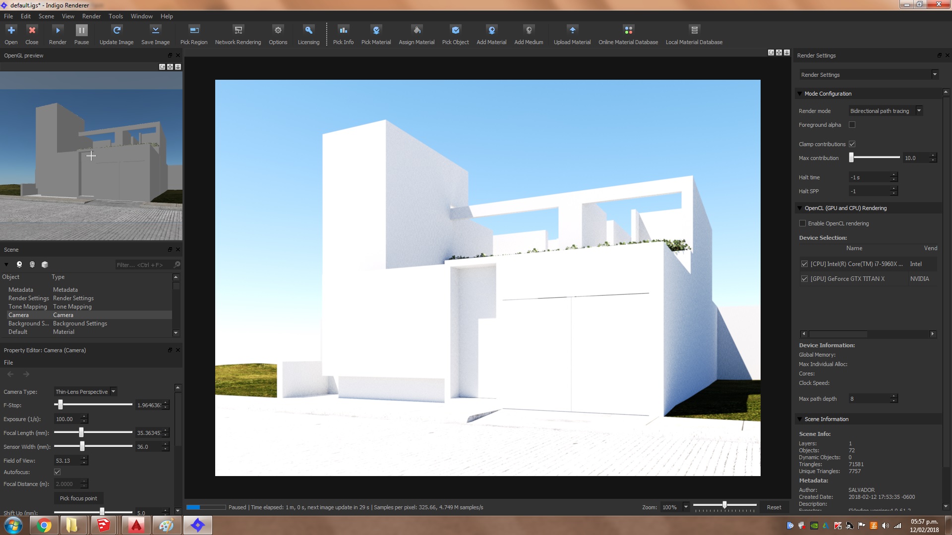

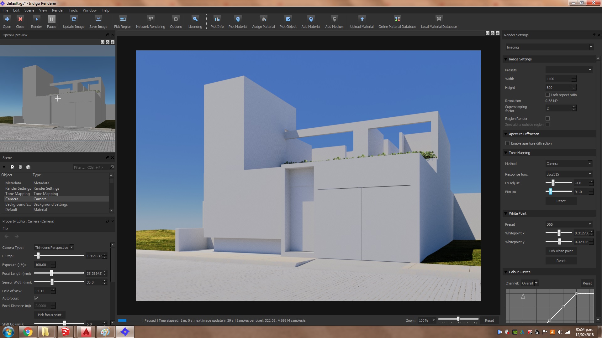

Post by Lal-O » Tue Feb 13, 2018 12:44 pm
Hi
Well , as i mentioned before ...i've been working with this new version of indigo and i said that everything was fine, but i must admit that there is a minor issue that is becoming a bit annoying...(It can be solved very easy -as user ,not as a programmer-). I'm not sure if it's worth reporting ...However, the issue is that the quality of the very first exported scene it looks weird , like washed out ...But if i make a re-render (like an orbit, a change in the field of view,zoom in or zoom out ...etc etc. )Then the displayed image get fixed with the same settings( EV adjust,ISO and rendering mode ). Attach some screen caps to be clear enough :)
