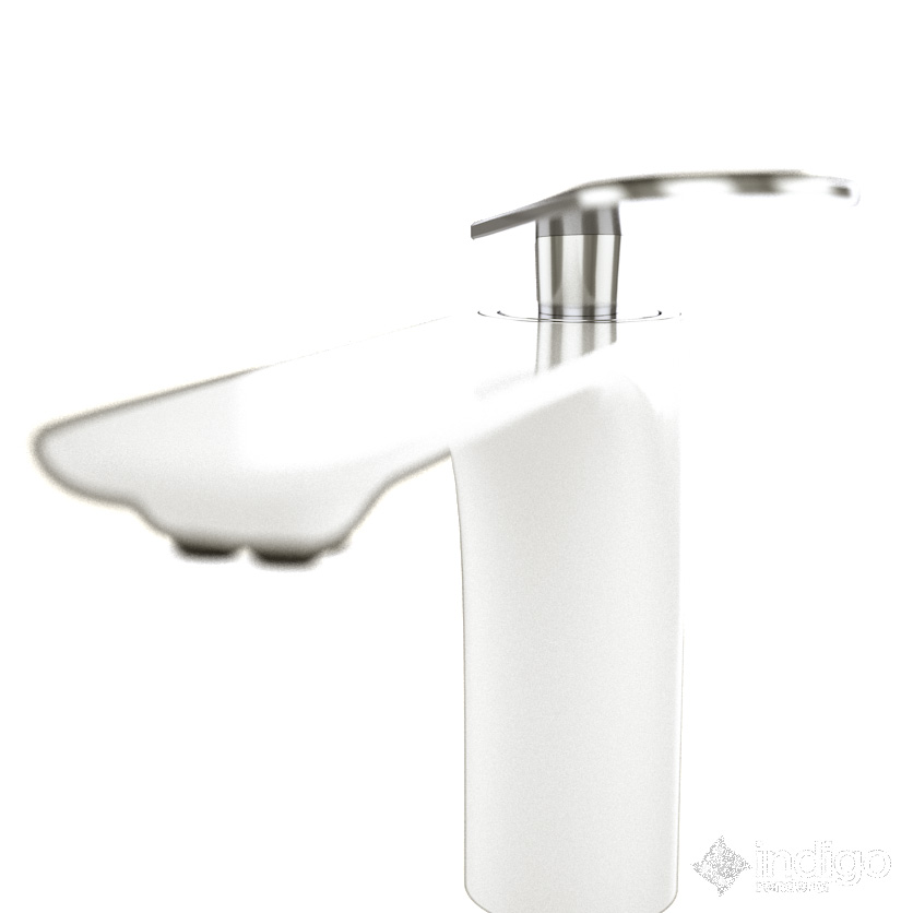

Hey guys, here's something to look at:
Since 4.0.48, foreground alpha produces an outline around the objects, but only in GPU mode. Just noticed it when putting in white backgrounds after days and days of rendering :-(
See the attached files... any ideas, or is it a bug?
All renders done with GPU (1060 6 GB, latest drivers), a quick test with BiDir didn't show the outlines on 4.048.
I stripped the scene to just the faucet and made it a pigs, can anyone confirm this behaviour?
FAUCET.pigs
(3.55 MiB) Downloaded 553 times
Stripped scene on 4.048 GPU
Stripped scene on 4.047 GPU
This is the scene rendered with 4.048 - notice the outlines?
This is how it is supposed to look - didn't cook as long though. Rendered with 4.047

Polinalkrimizei wrote:Hey guys, here's something to look at:
Have you tried the 4.0.49 release?

Confirmed! 4.0.49, Mac OS, ooooold ATI, OpenCL activated.
Whoops, sorry about that. This is one of the perils of using a beta version.
This issue has been fixed for the next build, the problem occurs when multiple light layers are used with alpha.
Polinalkrimizei
Posts: 649
Re: Indigo Renderer 4.0.48 Beta Release
Post by Polinalkrimizei » Thu Apr 06, 2017 12:33 am
Thanks Ono, that's awesome.
That new light layers (=>the preview) look fantastic btw!
