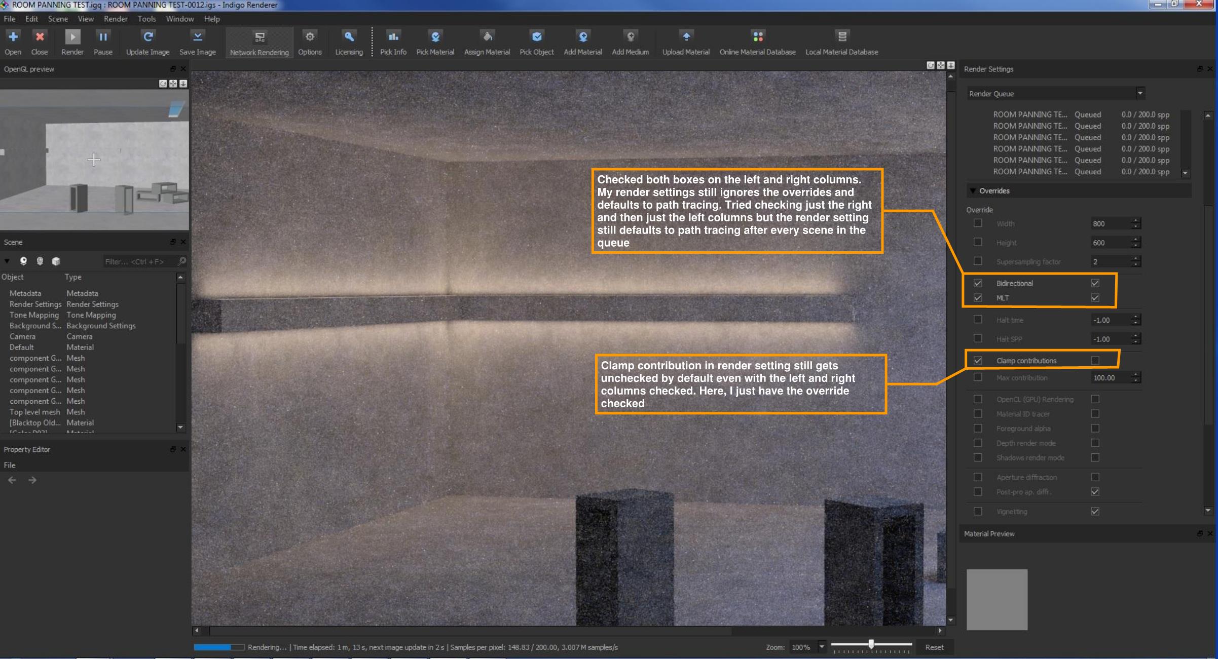

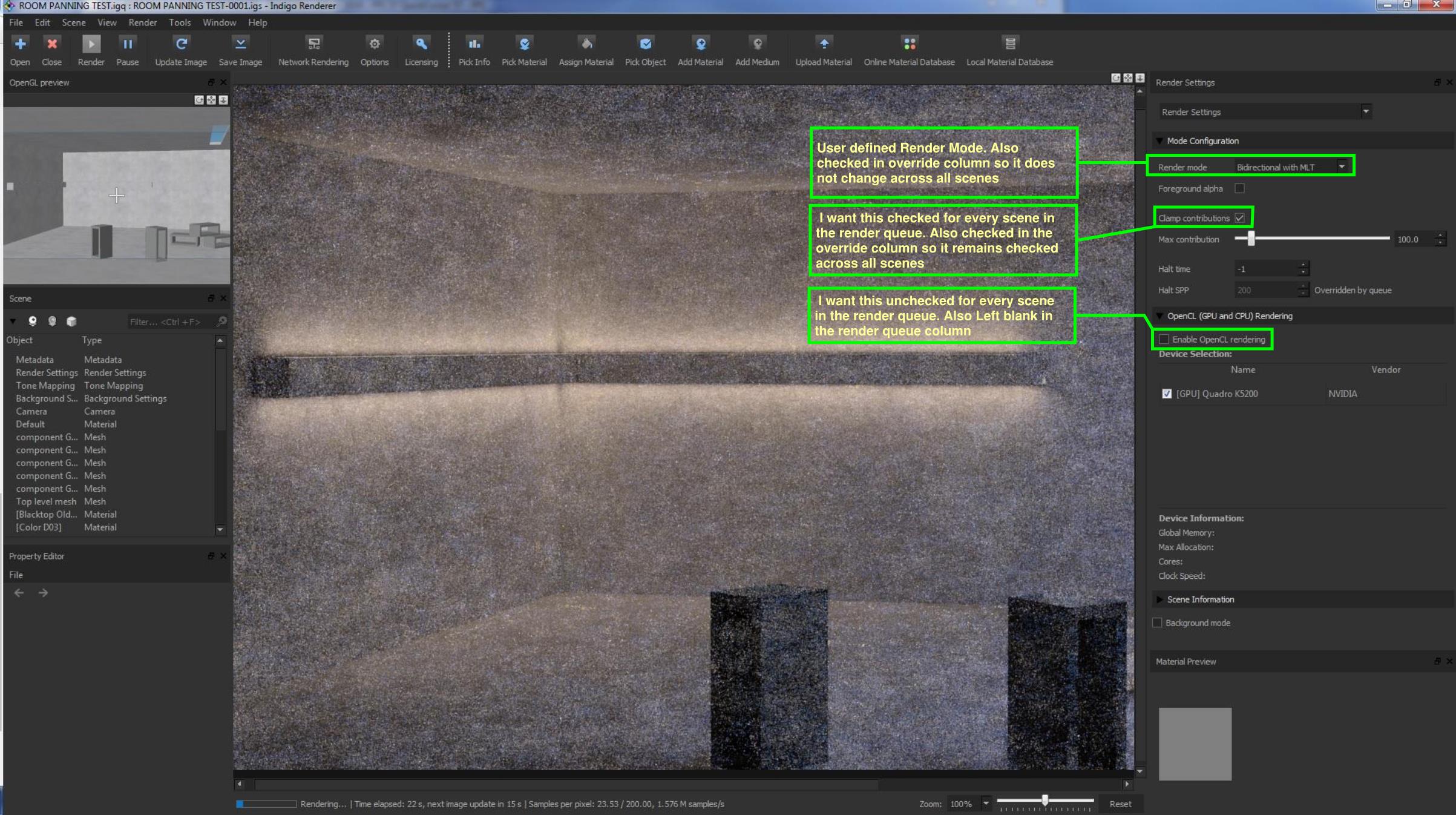

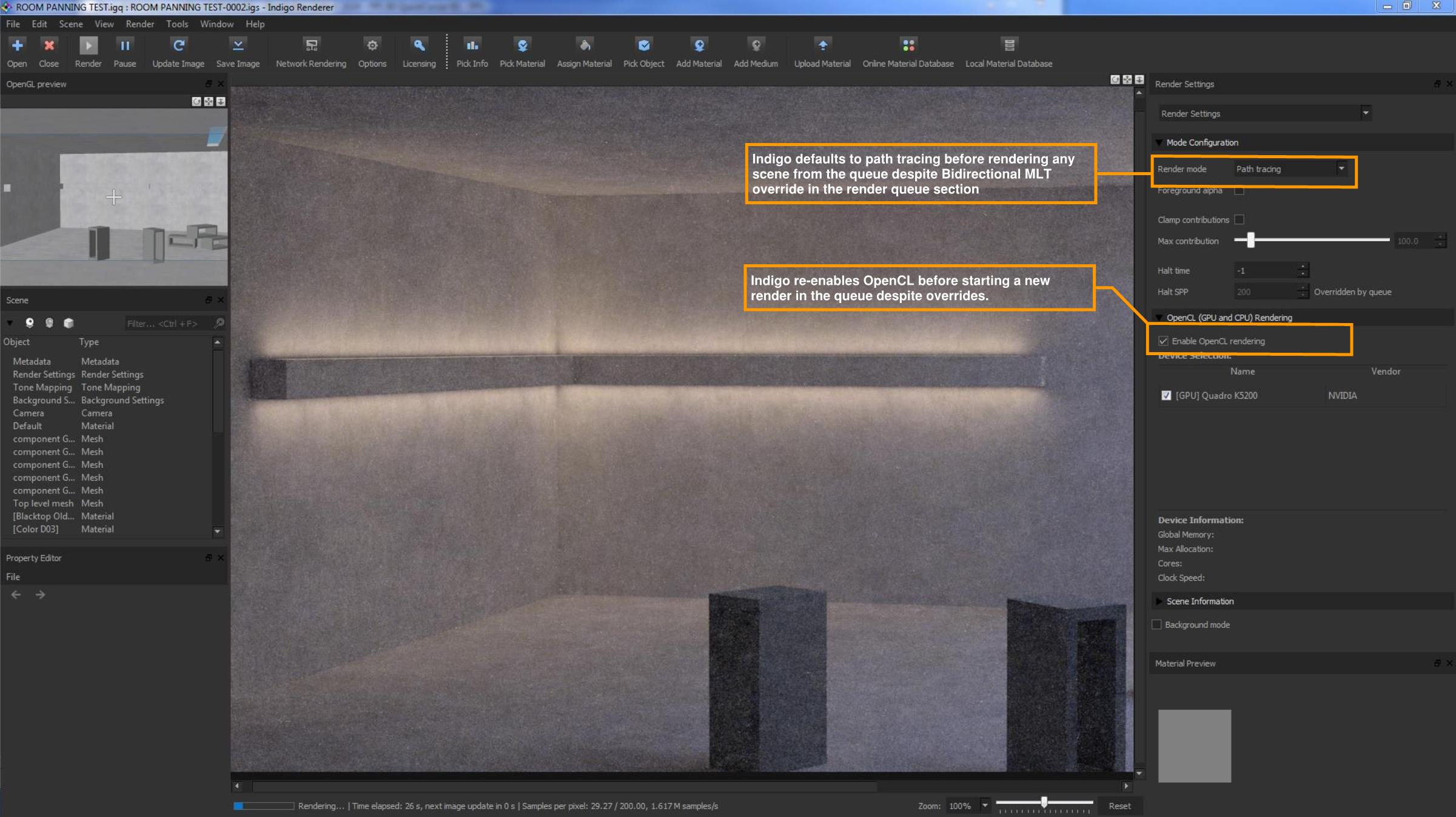

OnoSendai wrote:Lamme: check out the 4.0.44 release, with queue settings overrides: http://www.indigorenderer.com/forum/vie ... =1&t=14118
Thank for the response. Unfortunately, the problem still persists.
For some reason, the overrides are being ignored in the render settings. Please see images below:
Any help would be appreciated!
As a side note: The new UI is really cool. Icons et al :)

I actually thought so too that maybe the overrides might be working without the UI controls indicating it. However, I noticed that whenever Indigo re-enables OpenCL and unchecks Clamp contributions before each scene in the queue, the rendering speed drop significantly and my slave computer stops working till I manually uncheck OpenCL again.

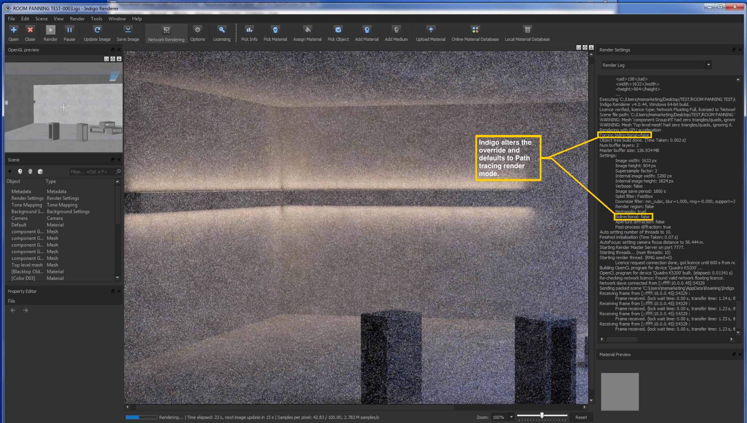

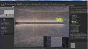

I re-rendered all my scenes and checked the logs. My finding are:
- Indigo does not apply "render mode" override settings from the render queue between each scene
sequence.
- I could not find the clamp contribution and OpenCL "true/false" status in the log. However, from the drop
in rendering speed, I believe Indigo also ignores the override settings for Clamp and OpenCL too.
Please see attached images.
Your feedback is appreciated
Thank you once again.
