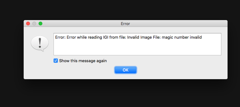

Hi,
It is not critical, but I found a new stuff yesterday. I use the RanchComputing renderfarm.
They use 3.8.23.
So I have to use this version on my workstation to be able to create 3.8.23 pigs files.
With the installation of 4.0.43 in an other location, the pigs files from 3.8.23 create background material and probably material with no "texture_index".
So to correct that, I had to re-intall 3.8.23 (same location of my original 3.8.23) to keep the creation of my pigs compatible.
That prove that 4.0.43 use the same parsing rules files even if you installed it at a different location.

The magic number. It means your IGI is corrupt/invalid.Originalplan® wrote:What number??? 3.14??

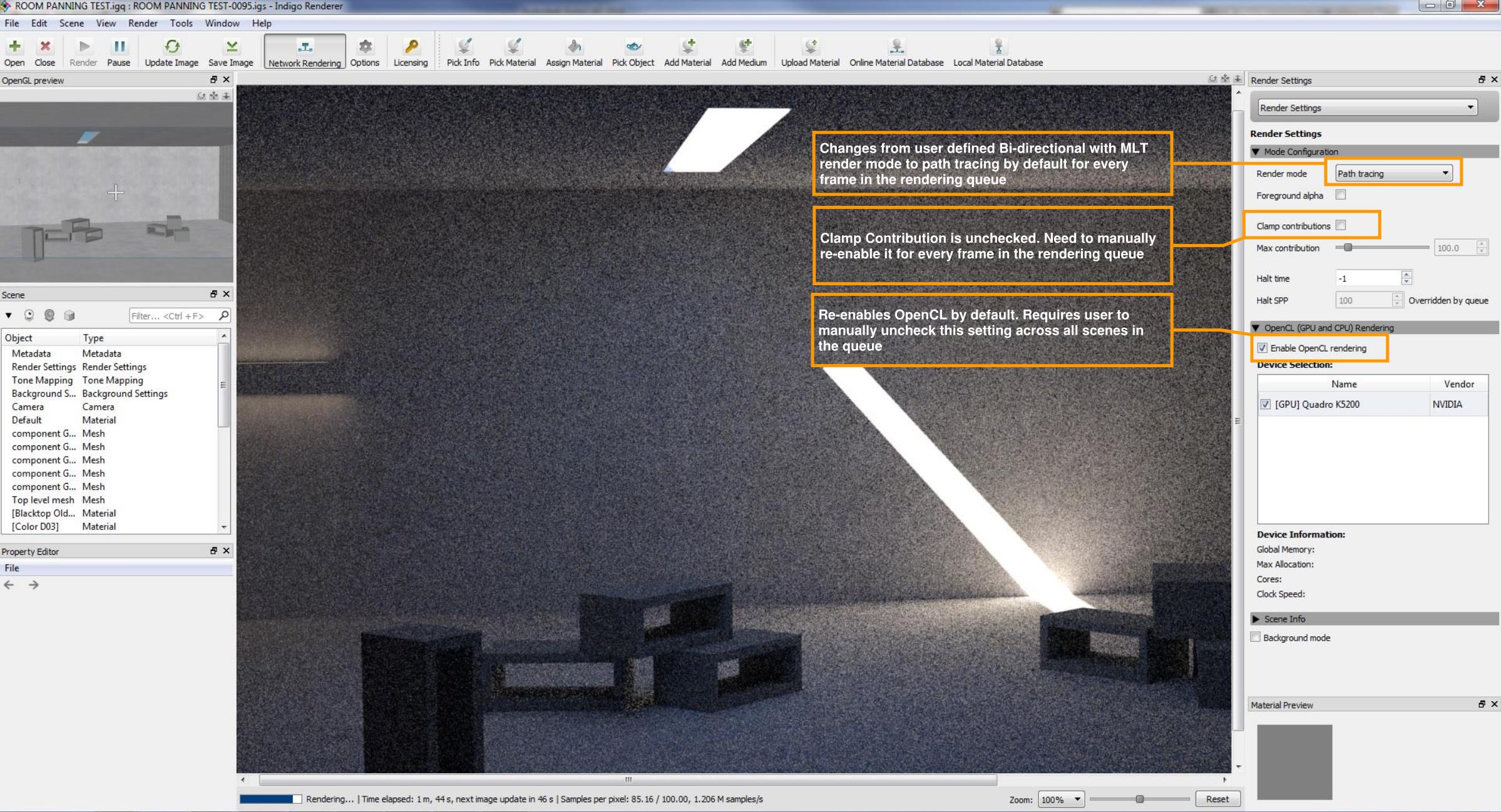

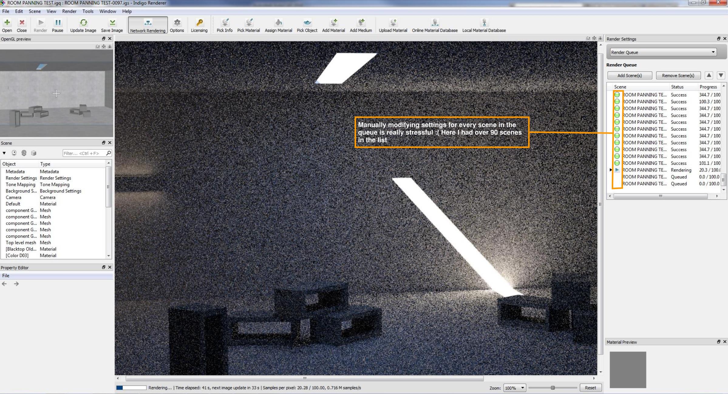

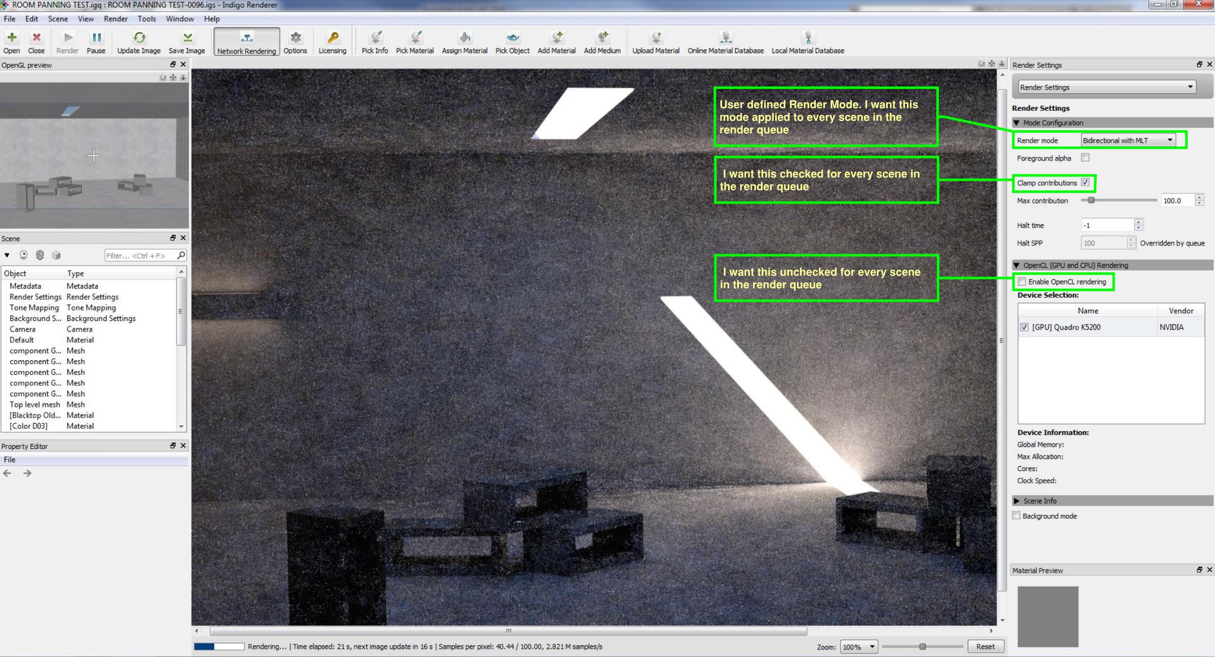

Hi all,
This is my first post on this amazing forum! :) And I need some help!
I am using SKindigo to create a short animation sequence; 25 fps with a 10 sec. scene transition between 2 scenes. So far, I noticed the following issues (I also included images to better illustrate the problem):
- Indigo defaults to path tracing before rendering a new scene in the render queue.
- Clamp contribution is turned off before rendering a new scene in the queue.
- Open CL is turned off before rendering a new scene in the render queue
Is there a way to override these behaviors? So that user defined render settings on one scene does not change and is implemented across all scenes in the render queue?
Comments and/or suggestion would be greatly appreciated!
Re: Indigo Renderer 4.0.43 Beta Release
Lamme: check out the 4.0.44 release, with queue settings overrides: http://www.indigorenderer.com/forum/vie ... =1&t=14118
